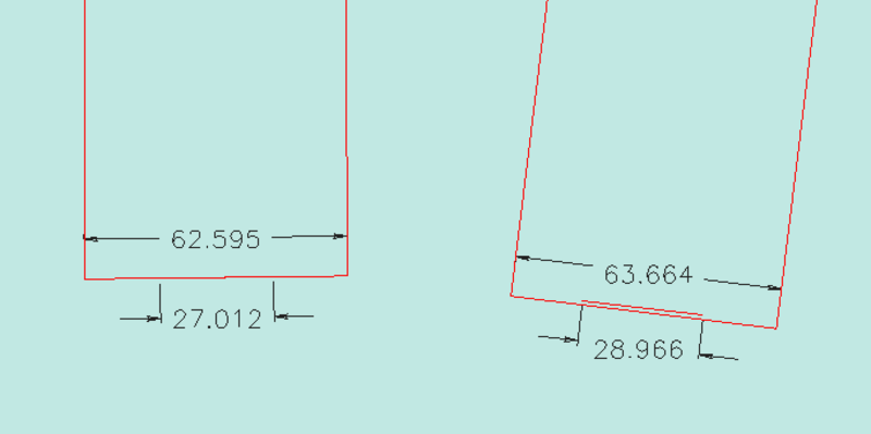

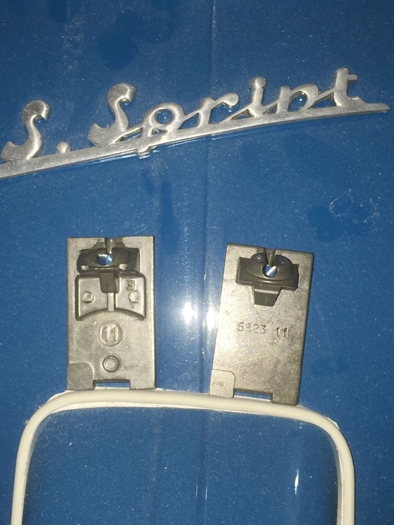

Go back to the first post, the slide on the right is from my 1986 PX (non-cat) and the one on the left was out of my 2015. I will let you conclude what slide you need to use if you want to run a non cat exhaust.
I am not here to get into a technical debate, only reporting what works, for not just me but for many Italians. The Italians have been doing this set up since Euro2 so this concept is not new or from my hard work.

I think its important to know what this slide does and if it will affect anything if changed,still talking euro 3 remember
Ive highlighed that all new 20/20 carbs come with this leaner slide
Someones telling me ive got lag and a lumpy idle running lean with this slide, Then others are saying it doesnt,who's right? Does this slide make your scooter run lean?

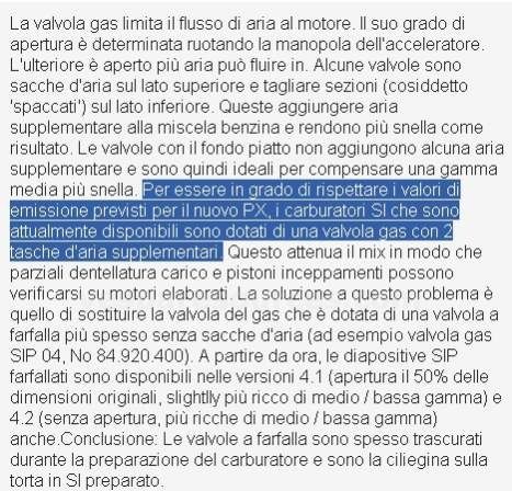

Well this is a much debated subject also on the Italian forums but this is what SIP has to say about the subject.
The gas valve restricts the flow of air to the engine . The degree of opening is determined by turning the throttle grip . The further it is opened the more air can flow in . Some valves have air pockets on the top side and cut sections ( so-called ' split ' ) on the underside . These add additional air to the petrol mix and make it leaner as a result . Valves with a flat bottom do not add any additional air and are therefore ideal for compensating a leaner middle range . To be able to comply with the emission values ​​planned for the new PX , the SI carburettors that are currently available are provided with a gas valve with 2 additional air pockets .This attenuates the mix so that partial load pinking and piston jams can occur on tuned engines . The solution to this problem is to replace the gas valve that is equipped with a butterfly valve more often without air pockets (e.g SIP gas valve 04 , No 84,920,400 ) . As of now , the SIP throttle slides are available in versions 4.1 (open 50% of the original size , slightly richer in mid / low range ) and 4.2 ( without opening , the richest of the medium / low range ) also . Conclusion : Throttle valves are often overlooked during the preparation of the carburettor and are the icing on the cake in SI prepared .

Number 1 = 6823.1
Number 6 = 6823.6
You need a number 11 but Dell'orto UK does not have them.
You need this one:
http://www.sip-scootershop.com/en/products/throttle+slide+dellorto+11+_68231100
But make sure it does not have the pockets like the one on the left in my photo, the one on the left was from my 2015 PX and the one on the right is from my 1986 PX.
On the left is 6823.11 from 2015 PX150 E3 and on the right is a 6823.11 from 1986 PX125E Arcobaleno

I would like someone to post a photo looking down a properly adjusted carb that shows any part of these topside pockets still being visible in the carb throat at idle or greater.
I still maintain they do nothing to alter airflow. The ones on the underside certainly do.

Somebody from an Italian forum actually wrote to dell'orto and received this response.
Oggi, il 27/07/15 scaricando la posta ho ricevuto questa e-mail:
Buon giorno,
questi scavi o unghiate nella valvola gas del carburatore SI servono, a seconda delle diverse dimensioni, a fornire un passaggio d'aria supplementare in determinate condizioni come ad esempio nella progressione.
Saluti
Stefano Prandini
Dell'Orto S.p.A.
Another regular SME also did gas analysis on the exhaust fumes and came to the conclusion that their was a difference between the two types, but I'm no expert on the matter so I will take his word on it.

The pockets do nothing, but...
The cutaway looks to be a different size. It may just be parallax in the photo, can someone that has the two slides measure it?
Best I can do with relative size of the cutaway in the picture:
not to scale
not to scale

I suspect Sig. Prandini is referring to the various depths of vents on the underside of various different valves that would fine tune air flow in the lower and mid range.
I'm with Patrick, the ones on top do nothing. There could be other minute differences between SPACO and INC, but I bet those are just mfg slop and worrying too much them is probably, as someone else said, the equivalent of picking fly shit out of pepper.
