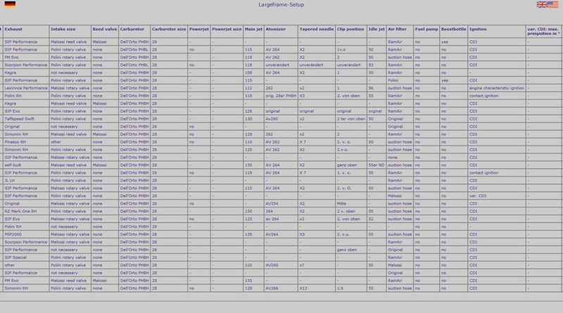

Why 28mm?
I got it coz it was available & after a lot of research decided that i wanted it... I saw something about "stage 5(or7) tuning once, & aimed for that as a start.
But i would go for a 25mm, as it would be far easier to set-up & more fuel efficient... Jus don't tell Ginchi I said that.
There has been many occasion where i got 64km out of a tank! Yip, its thirsty!
This chart will help.
Posts: 246
Posts: 246
Cheers,starting to get a better understanding,that charts good,thats why i was asking for setups on the forum so i could ask a few more questions on porting,carbs etc
