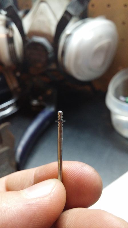

Hey everyone, just wanted to know what your advice is on what i should do to get my tune right on my scooter. I have a 2006 piaggio typhoon with a malossi iron 70cc kit, stock delortto 17.5 carb with the brass restrictor removed, a pocket bike style air filter, and i am currently running a 102 main jet and a 32 idle jet. The top end seems to be pretty spot on with a slight bog at wot but my biggest issue is take off. The scooter struggles at 1/4 throttle and smokes like crazy. Ive tired adjusting the air/fuel mixture and it didn't change much. Any help would be very appreciated! Btw I ordered a 45 idle jet for shits and giggles and i have no idea if its going to work, ill post what happens if i have a chance to try it out.

Just making sure, you want me to bring this clip up one or two notches to drop the needle?

I expanded the second hole that divides the airbox, and take off the rubber restrictor tip if not done yet.....
If using the original airbox, the needle has to be at the second notch from the top, and use a 78 main jet......85 is way too big...That was my setup with a 70cc Polini Corsa... 17.5 delorto.....I have jets from 100 to 60...and worked them down to 78....If you are getting bogging, you are too rich, if your speed and acceleration is less, you are too lean....get a 6mm jet pack....
You showed the needle at the third notch from the top...

*update* currently my needle clip is set at the 1st notch, im running a 34 idle jet, and a 85 main jet. I adjusted the air/fuel mixture screw today and i got everything running spot on. Plug colour looks good too. My only problem I'm dealing with is the engine sputtering a ton when its cold. Ill make another post on that since my main issue is solved. Thanks a ton for the help greg531 and motovista!

Try the second notch in the needle...Tuning is a lot of playing around....and try one thing at a time, and see if it helps....
