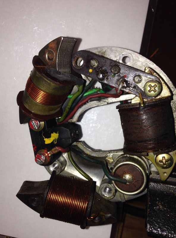

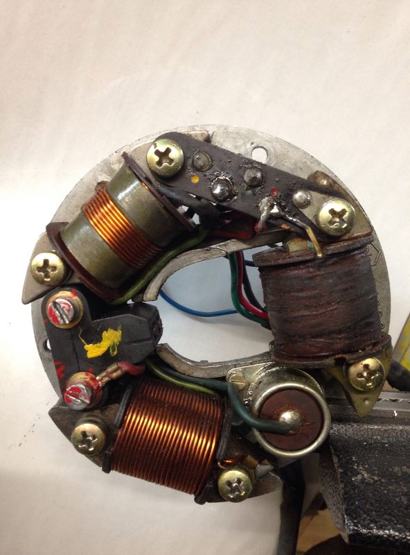

Here is the stator, up close. On the bridge, there are no yellow wires. Even though clearly there were some time in the past.

The bottom coil is wired to upper left coil with the light green wire. I believe this confirms the 12v conversion job.
Do those two coils look original? Or do they look like aftermarket coils added later in life?
