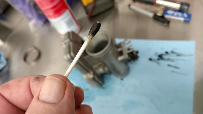

Ok, I may have solved the problem. Sorry it took so long, but, what the heck, the scooter was running.
The problem had been a check engine light after a few minutes of idle, a few times at speed, and occasional engine shut down at idle. It would restart and if you added throttle at any time the light would go away. This problem had been around for the last 8 months and 7,000 miles. Computer fault said O2 sensor and we changed that with no change.
tvnacman
did you clean the throttle body?
At idle the throttle is completely closed, and uses passages in the throttle body.

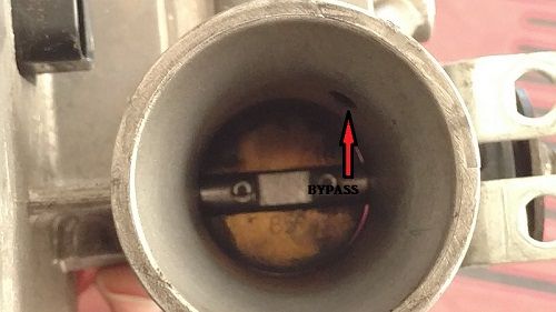

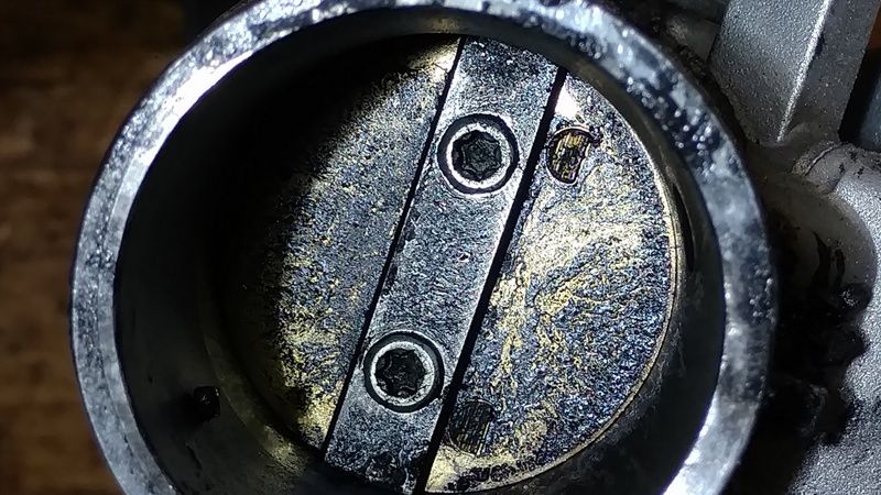

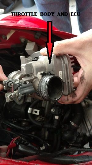

I finally had time and Darren finally had time so I took it down to him at Vespa Servicing in Bradenton to pull and clean the thorttle. I had not jumped in to this area before and wanted knowledge and to get it done in 2 hours instead of 10. You will see from the pictures that it was really needed. We had tried spraying carburetor cleaner a while back with no luck and to be honest did not expect any.
In the throttle body there is a small bypass that comes into play at ideal. It took about 6 q-tips and lots of carburetor cleaner to clean it.

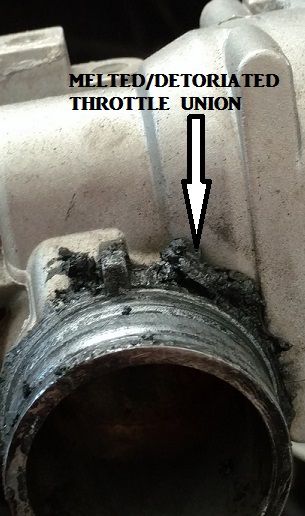

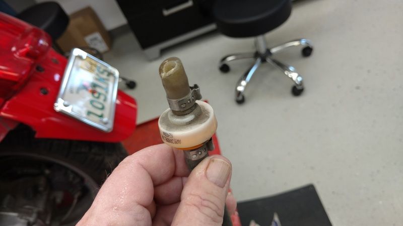

We knew that the throttle union was deteriorated and had ordered a new. However, the evap connection was on the opposite side from the location on the old one. Instead of installing a longer tube we chose to just disconnect the evap system.
In the process of doing this we found that evap tube was deteriorated and broken and had been for some time.
For now all is well and I feel that it will stay that way until Everett, Washington

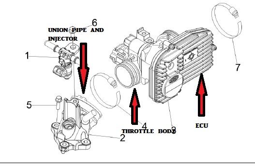

these are the parts we worked on
removal
removal
the melted rubber from the union. the union is a metal piece coated in rubber.
yuck!!
yuck!!
see that little hole in there
a lot of cleaner and qtips
the busted evap line.
