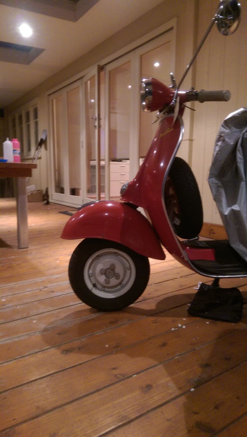

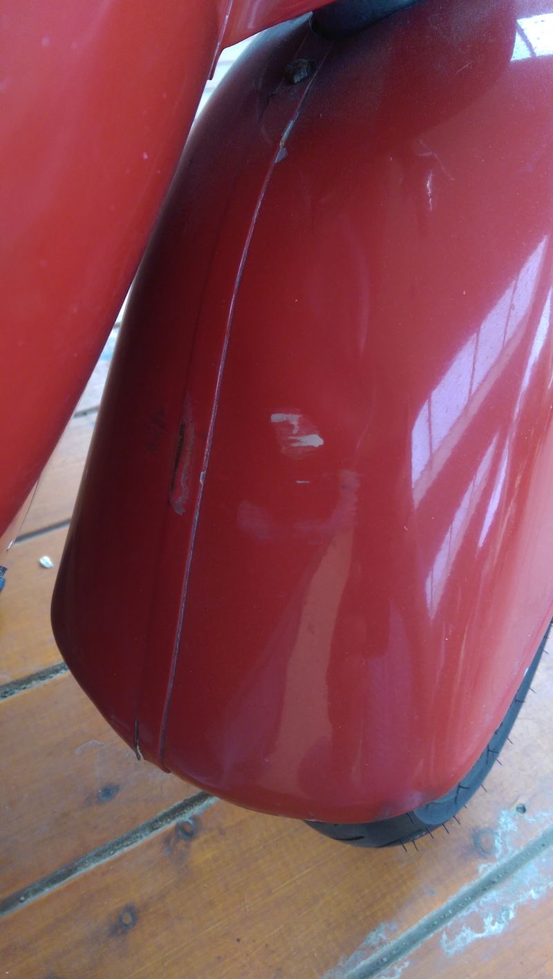

Hi, since I have owned my Allstate I have had the gut feeling about the front fork been bent. At some stage the original pogo stick fork was replaced with a vnb one. When I let go at the handlebar on the straight it goes dead straight. The only problem the front mudguard rubs on the shield. Can someone tell me please what the gap should be with the legshield? Before I buy a new fork from India (which could be a big mistake) Can anyone tell me if it is possible to make the one I have straight again.

From what I can make of it there isn't a lot of gap! Right?

Hi Ginch, Sorry I didn't reply sooner. here are the photos

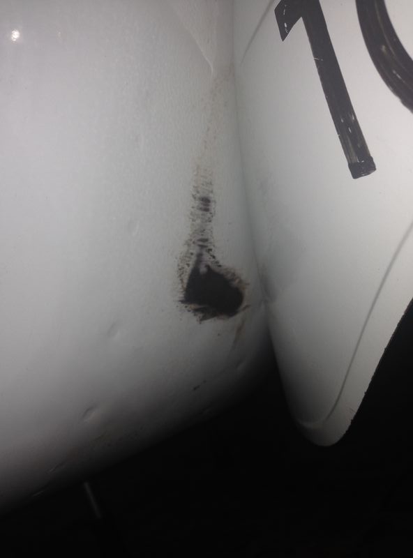

Thank you Blank,
as you can see from the pictures i dont have a gap at all, what puzzle me is how is ti possible for the fork to be bent and the scooter still goes stright

Can you try to bend it a little?
How about a picture from the motor side, taken from about 2-3 metres away? It migh tell us something.

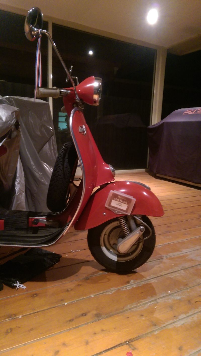

See if this helps

It needs to be from the engine side so we can see the fork.

Mine was like that. I pulled the fork out and it was straight. Turns out it was just the guard so was the frame. It bent out pretty easily. I've found if you even loosen them off there can be some play in them before you bend. Here's a pic of where mine was rubbing against the frame.

How's this!?

It looks like as if it is in the same area

Yeah I think Blank is right... I'd try that.
Most pictures with that type of guard show it higher at the front, less central over the wheel.

Des it look bent to anyone?
