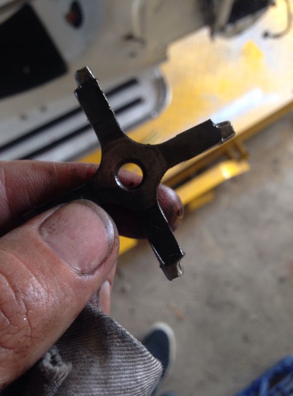

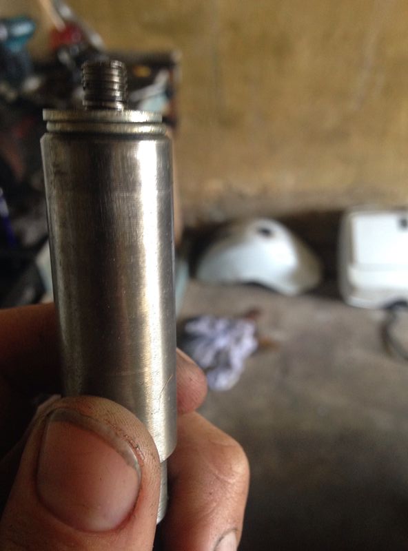

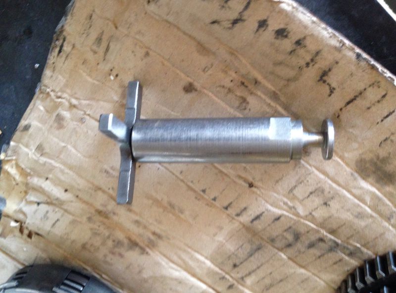

Just wanting to know if anyone has a definitive answer as when I pulled this engine apart it had three random washers in there.
This the cruciform I pulled and the gear selector rod with 2 washers. One still in the shaft.
Any help would be appreciated.

Selector rod

Not so sure about 91 px models, but my '80 pe 200 had the one fat washer between the rod and the cruciform. without it, it didn't find third or fourth properly.
have a hanyes manual to confirm?

One of my engines is an EFL from around that time.
No washer, cruciform of the flat type. Your's looks like it has some angles?
Maybe someone fitted the wrong cross and shimmed it up with washers.
I might of c be wrong. It has happened.

You have the wrong type of selector rod for EFL.
The cruciform you have is EFL type.
EFL doesn't use washer between selector rod and cruciform.

Ahhhhhhhhh yes. Lifesaver.
Thanks so much.
I was so confused.
Who bodged this job. Rascals.
Case closed.

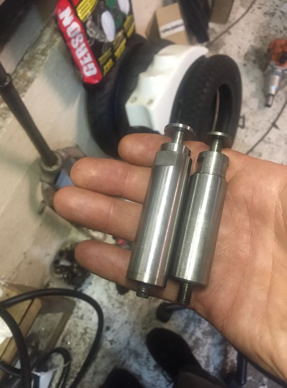

Correct plunger and cruciform combination.

You got it.
