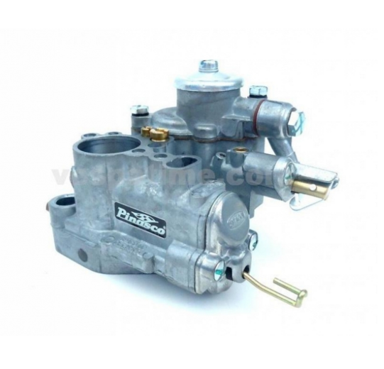

Carburettor pinasco si26-26g for vespa without mixer

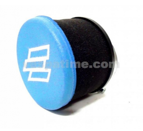

Air filter polini for vespa largeframe

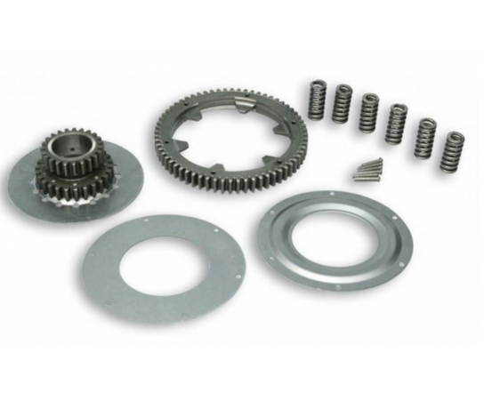

Gear ratio primary increased malossi 24-63 for vespa px 200, px125t5

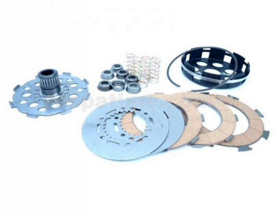

Kit clutch pinasco 7 springs set for vespa px200, rally 200

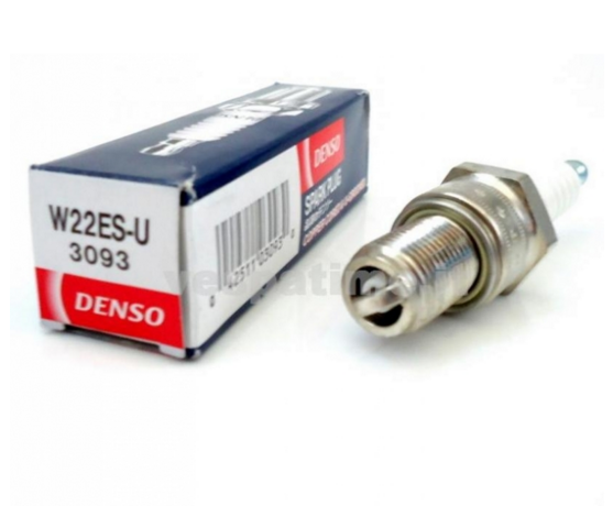

Spark plug denso for vespa 180ss, 180/200 rally, 200 px/pe
