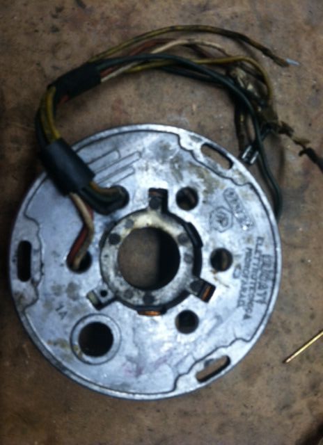

So I have attached a picture of the electric stator that I have. If anyone knows what volts it takes by looking at it... It is a Ducati and will definitely need to be re-wired.
Posts: 920
Location: The Bank
Posts: 920
Location: The Bank
Looks like a p200 stator. The horn should still work with modification to the switch. You can modify the foot break switch to work. The only unique part that I can think of would be the flywheel. It'll need to fit the crank for VBC, but be built for electronic ignition like a p125.
