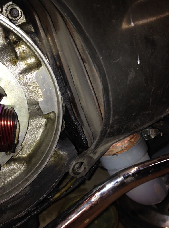

Been chasing a high rpm stumble, haven't been able to jet it out. This is a stock p200, only mod is the sip road. Pulled the flywheel to have a look at the fly side seal and found the cylinder base wet. Could this be my issue? Can I pull the cylinder with engine in frame?

Seems easy enough. I'll have a look at it. I'm just thinking "that shouldn't be wet". There's 2 stroke spooge on my gear cables and such below that, so it seems it could be a part of my issue.

mine was leaking there and didn't want to to stop. Some hi-temp fuel resistant liquid gasket helped straighten it out.

I use MotoSeal down there, never had a problem.

+1 on studs and motoseal. Not saying your problem is the same as mine, but I fixed high engine stumble with all new ignition. I had multiple flywheels, stators and cdi. But all new is what fixed it. Could have been anyone of the three. I'll never know.

Is that pipe on all the way up the cylinder stub? Looks to be a gap in the pic which may be the source of that high rpm stumble

I think so but definitely worth a check. Been busy with relatives in town, haven't moved on this yet.

it was indeed falling down a bit. Finished up my fly side seal and positioned this correctly and will see if I've got it. Will fix the base gasket leak next but I'm dying to isolate the cause so one item at a time. The fly side seal looked good but I changed it anyway for insurance.

Btw the exhaust and fly side seal didn't cure it...
