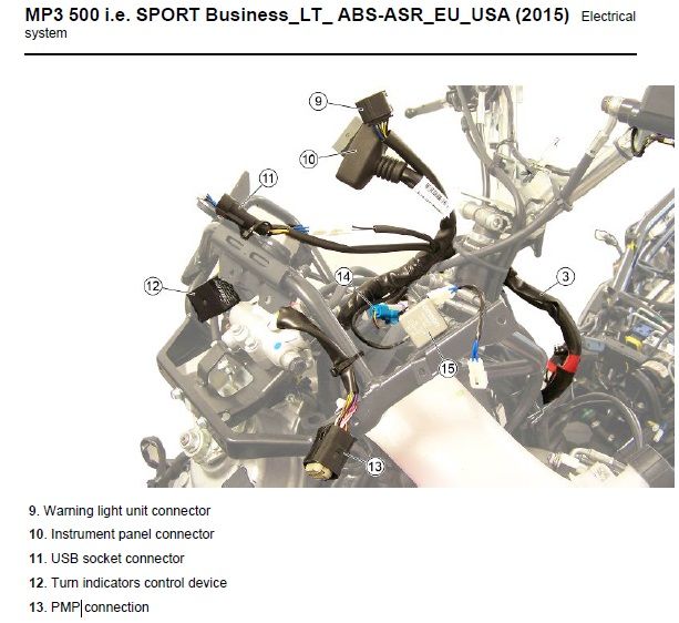

Had a member on the modern side ask me about the PMP / VMP app. I question if his new MP3 has the Bluetooth module installed. Can someone forward me it's installed location with a possible pic of the module in place?
Appreciate your help.
Bob

I don't have a picture of mine mounted, but it is just under the Windshield ABS. Here is the picture from the Service Manual showing the connecting plug. Real easy install, you do need to purchase the mounting bracket.
