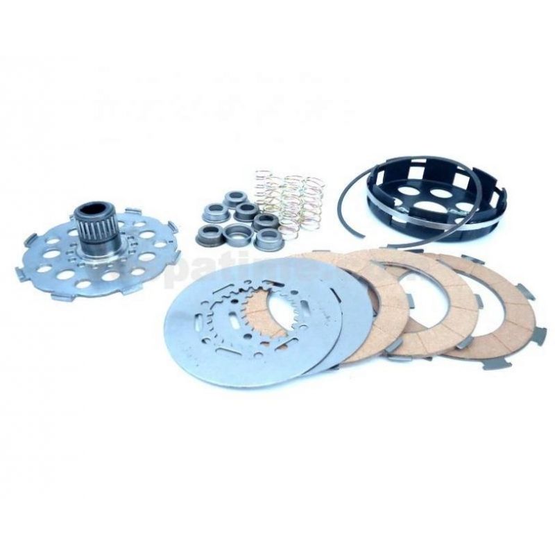

Guys ı m preparing to install malossi 210 kit and polini ignition. Vespatime advice me this clutch setup.Is it handle the power and useful to daily drive?Anyone experinece?

yes - its basket is banded/reinforced to handle power as the stock item can explode from higher revs and power.

probably overkill, and those look like reinforced springs witch will be murder on your hands i na daily driver.

Do you know any product feeling like stock but reinforced?

well... how far is this built? the stock unit can take a bit more punishment than you'd think.
unless you are going crazy with it i'd throw a banded basket at most.
most who want to go to a more rugged clutch go to the later cosa style as it has more plates and requires much less spring pressure to not slip.
A cosa with an upgraded basket to take 16 springs instead of the normal 8 is fairly easy on the hands.
however, they are not all created equal; usually i recommend going to clutch basket by a tuning company as there have been fit issues with the stock-style ones.

Looks like a good setup. I put together the same basic thing. I used:
SIP SeriePro banded clutch basket
Surflex Plates
Pinasco Sport Springs
Clutch pull is not much greater than stock. Scootermercato has the plates and basket. Not sure on the springs though.

get a reinforced circlip... those wee ones fall out with a bit of thrashing & engine braking
