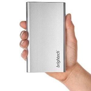

V you need one of these. I got mine for $39 (Black Friday deal is a lot of BS ) on Amazon. "Special" for Black Friday is $49. Unbelievable.It's lighter than my 6+ iphone and jump started a truck . The alligator clamps are scooter friendly. This would fit nicely in your pet carrier. You can also charge you phones,tablets etc. It's by Brightech and it's the Python model jump starter. Best $40 i ever spent. Used it a couple of times already TOMMY or kick starters are crap. Some people can do it but it's easy to crack the tranny case. V why don't you get a new battery? I'm thinking you mostly take short trips so your not really allowing the battery to charge fully.
