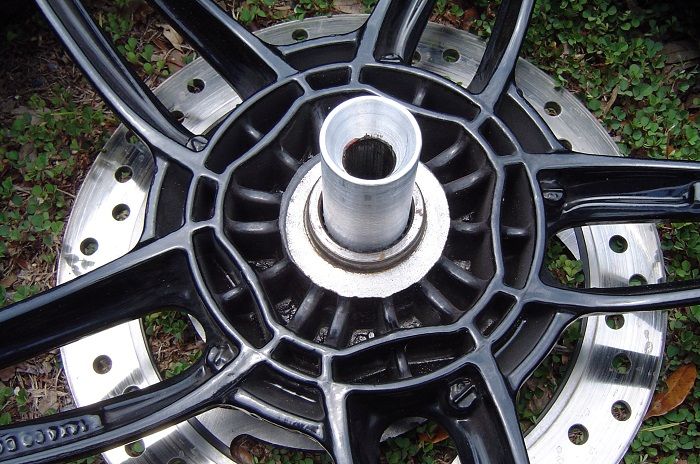

Yes, if you have a lathe and the knowhow
When I bought my 2015 BV, I noticed a gallop when doing 10-50MPH. Not a wobble, an up and down bounce that wasn't noticeable above 50MPH. So I had 2 choices. Bad tire/balance or suspension. Taking the easy way, I put dyna beads in the front tire and they made no change. After breaking the bead and vacuuming out the dyna beads, I rebalanced the tire on my Harbor Freight balancer. No change. So I had the wheel spin balanced. That decreased the gallop about 80%.
So I've come to the conclusion that the best way to balance MY tires is to have them spin balanced.
While I'm waiting for parts for the bearing replacement, I've been putting in extra effort to my commuter(2014) bike. So I figured, good time to make a way to spin balance the rear tire.
Now it's time to praise the people at CycleGear. Not only do they spin balance tires for free. Alex at the Orange Park location, allowed me to measure their machine to make what was necessary to do my wheel

I know that the shaft on the spin balancer at CycleGear is 14mm, but I don't know what the front axle shaft is. If you can machine a sleeve that will remove the slop between the balancer shaft and the inner race of the wheel bearing, you will get the best balance. The dealer might not have a spin balancer. The only time I won't have my wheels spin balanced, is when it's not available. After my recent experience, no one can convince me that any other method is better than spin balancing.

I'm a prototype machinist for a small company. If you were in San Diego, I'd ask you for a Job

I just checked. The inner race of the wheel bearing is 20mm. So, if you have a sleeve with an O.D. of .785in.(20mm is .7874in) and use a 14mm drill to make the I.D. you would have the needed sleeve.

I've found after more riding that the "Lumpy" issue is a harmonic that is most prevalent in the 40-55 MPH range. It comes and goes as I ride and seems to have the largest amplitude when leaned over about 15 degrees or more. Strange.
Now that I'm confident that my front tire is in balance, I'd like to check the rear tire's potential for being out of balance by running the scoot' on the centerstand at ~45MPH. I'd be sitting on the scoot' and holding the front brake. Is this a good idea?

I rebalanced my front tire and the issue remains. Frustrating. I'm probably going to start the dealer dance with A&S in Sacramento where I bought the scoot' three weeks ago. I really dislike the dance as dealers often treat customers with little respect. The A&S sales person was not very professional but the price was attractive and I certainly didn't expect a tire problem from Michelin. I also just found that the high beam on the upper headlight burned out.

WEB-Tech.
I tried that but the drag was too high. Then I loosened the axle to see if that would reduce the drag but eventually had to remove the wheel.
I'm going to remove the rear wheel next. If it is not quite a ways out of balance I'm going to replace the brand new City Grips (it's on a new BV350 with 420 miles) with new Michelin's that are NOT CG's.
