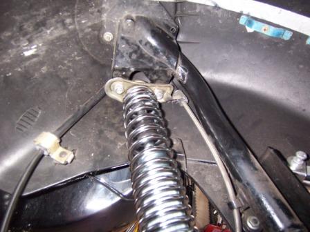

Another look at the upper shock mount point.
The flat end points forward and has the cable bracket installed on it.

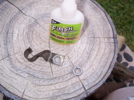

I used super glue to attach the lock washers to the upper mounting bracket.

On your top mount base, it looks as if there's a bolt missing (in the white circle). Is it?
@greasy125 avatar
Posts: 15121
@greasy125 avatar
Posts: 15121
yes, there is a bolt missing there.
it is one of three that mounts the fender to the fork. it's a small shouldered phillips top with a washered nut from the bottom.

I cant seem to get the top suspension mount off the factory suspension. Is there a particular trick to it? I have the factory shock off the bike but I cant secure it well enough to turn the bolt at the top of it to remove the mounting plate. Suggestions?

I cant tell the difference as I changed the Bitubos on my build before picking her up
They are sweet thou...
