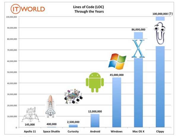

I don't know about a Vespa, but many modern cars have more that 100,000,000 (that's one hundred million) lines of code. http://tinyurl.com/zwczp55
So, yeah, probably.
Here is Apollo 11:
