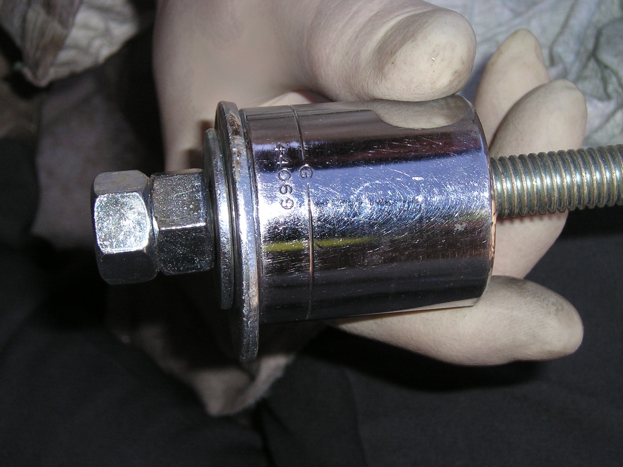

Use not the brute force, Retro.
Poor man's press you must construct, with threaded rod, fender washers, and maybe a socket or two of the correct size.
Everything like a nail looks while using the hammer.
Like Yoda I am typing today.
Very much you are welcome.

Nice tool. I could have used that but today I went to the dark side.
