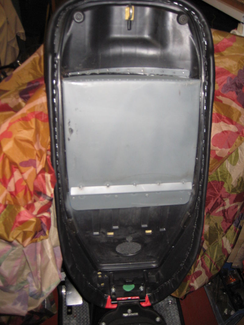

I attacked this issue on my 2009 mp3 500. the sliding forward was horrible.
what I did:
lower rear shocks one inch
lower rear tire 140/60 (not for everybody but I LOVE it)
raised front bucket by .5 inch. I did whole bucket so I wouldn't loose my compartment seal. my bike is semi-naked. everyone else can raise front of seat bracket but seat bucket will not be sealed. no idea how fast dust would get in.
recovering my seat. I grind away about .25 of plastic to make seat area more bucket like.
then I raise the very front of seat with .5 inch extra padding. I try the 10mm thick gel both over and under padding. seat comfort did not improve and it make me slide forward again. my but sink into the softer original padding better.
after all the tweeks I would say problem was about 90% removed. I weigh 170lbs.
uncomfortable seat just ruins the riding experience.

I cut quite a bit off the base of the seat at the front end and sides along with quite alot from the top of the seat foam especialy at the front end where you don't sit. I should have taken a photo of the original seat on the fuoco to show the difference .I added the sheet steel addition under the original pan ( thats were it is cut out so i sit lower. If i was going to do another i think i would make it in fibreglass and probably make a new complete 1 piece pan.I can now sit alot further back on the seat and still put both feet on the ground almost flat i'm 32" inside leg.

I like a lot of things about your seat.

I like a lot of things about the entire scoot! That thing is NICE!
