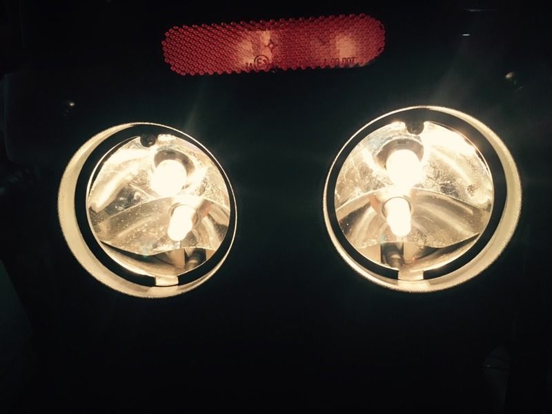

Hi guys.
My MP3-500 has a weird problem regarding brake lights. Basically, when I apply the brakes, either the front or rear or both, the brake lights don't light up. I can start the bike just fine, no problem. So I remove the 2 red circular lens cover off. Started the bike, and I could see all 4 bulbs working.
Is there a fuse for the brake lights? Or both my brake light switches have gone bad at the same time?

Thanks, Kiki2016 and 3legsofman.
The bulbs are working just fine, as you can see from the pic. I also checked the fuse and it was ok, of course, since the bulbs are lit. I guess the brake light switches are shot then. I can't believe both switches have gone bad at the same time.
Though one question remains - are the brake light bulbs double filament?

I'm still not understanding the original post. The OP states the brake lights don't work, then shows that they are working...
And it's not uncommon that when an owner discovers the brake lights don't work (because the bike won't start with the left-hand brake lever) that they also discover the brake lights won't work with the right-hand lever as well. This is because 50% of the time the RH switch will fail first, but this is unnoticed until the LH one fails as well.

My understanding of the problem is the bike starts ok but when the brakes are operated he cannot see the brake lights light up and that is because they are already lit as he has found out by removing the rear lens . My first post was to ask if anyone had been messing about with the wiring .

That is correct. The stop light bulbs are already lit up even when not applying either brakes. I am positive no one has been fooling around with the wiring as I keep the bike inside my garage all the time.

the brake lights are lit all the time. replace the switches at the levers, they are stuck closed. $12 each

Hi 3legs. Yes, they worked flawlessly until a few days ago (when I had to brake hard when an elderly woman decided to share lanes with me at the last second). Funny thing when it happened, I swore the front brakes pulsated as if the brakes were ABS. Anyways, I am now certain the wiring is still intact. I just need to replace both brake light switches.
