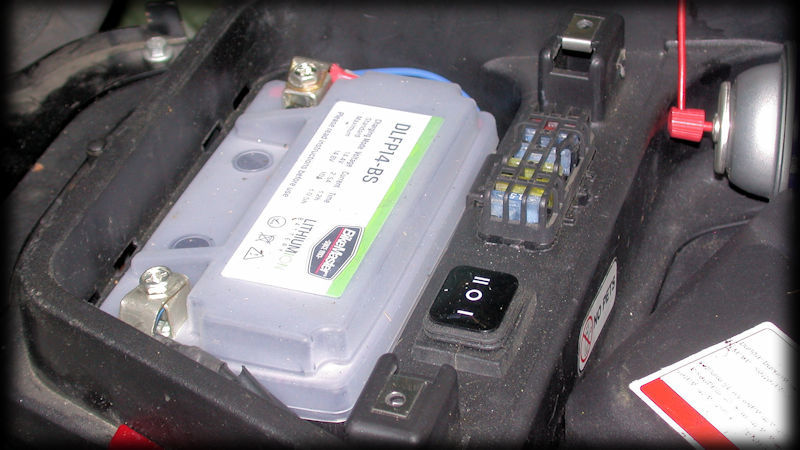

@bronto avatar
MP3 500ie
Posts: 37
Location: SF Bay Area
@bronto avatar
MP3 500ie
Posts: 37
Not long term review.
Trying out a Lithium battery. If its as good as they say, we'll see. One thing for sure it weighs nothing, like a box of feathers.
It holds a charge for weeks without charging. Very good cranking power. Not much more costly than other Scooter batteries.
