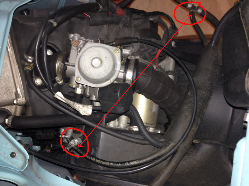

Noticed this today after I removed the storage bucket. One end connects to T on other side and one and (with hose clamp) goes nowhere. What am I seeing? [img][/img]

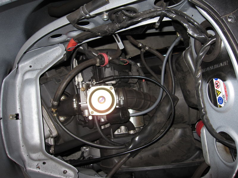

It is part of the Evaporative emission system, the hose attaches to the left side of the carburetor

Ok, but does it have to be connected? Apparently it popped off at some point and I've been riding it.
