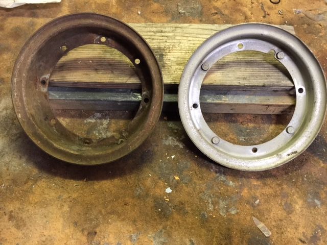

We saw a tip on one of the hot rod forums about using diluted muriatic acid to remove heavy rust.
We had some muriatic acid on hand for the swimming pool - so we tried it on an old rim.
Holy cow... it works!
Dilute the muriatic acid with 50/50 water. Spray it on. Let it sit for about 10 minutes and do its thing. The rust pretty much dissolves right before your eyes. To stop the process, rinse with some baking soda dissolved in water.
Not for the faint of heart though. Muriatic acid is nasty stuff. Wear gloves and stay away from the fumes.
Rim on right looked just like rim on left before rust removal
~~~that rim cleaned up nicely! I have some muratic acid so I will try your suggestion when I do the back (rear) wheel, hopefully sooner rather than later...this job is taking too long...I want to ride it=:-)
I'll be sure to report back, just to let you know how it went for me, using the acid you said to use...
thanks for the tip...it looks like a winner!
