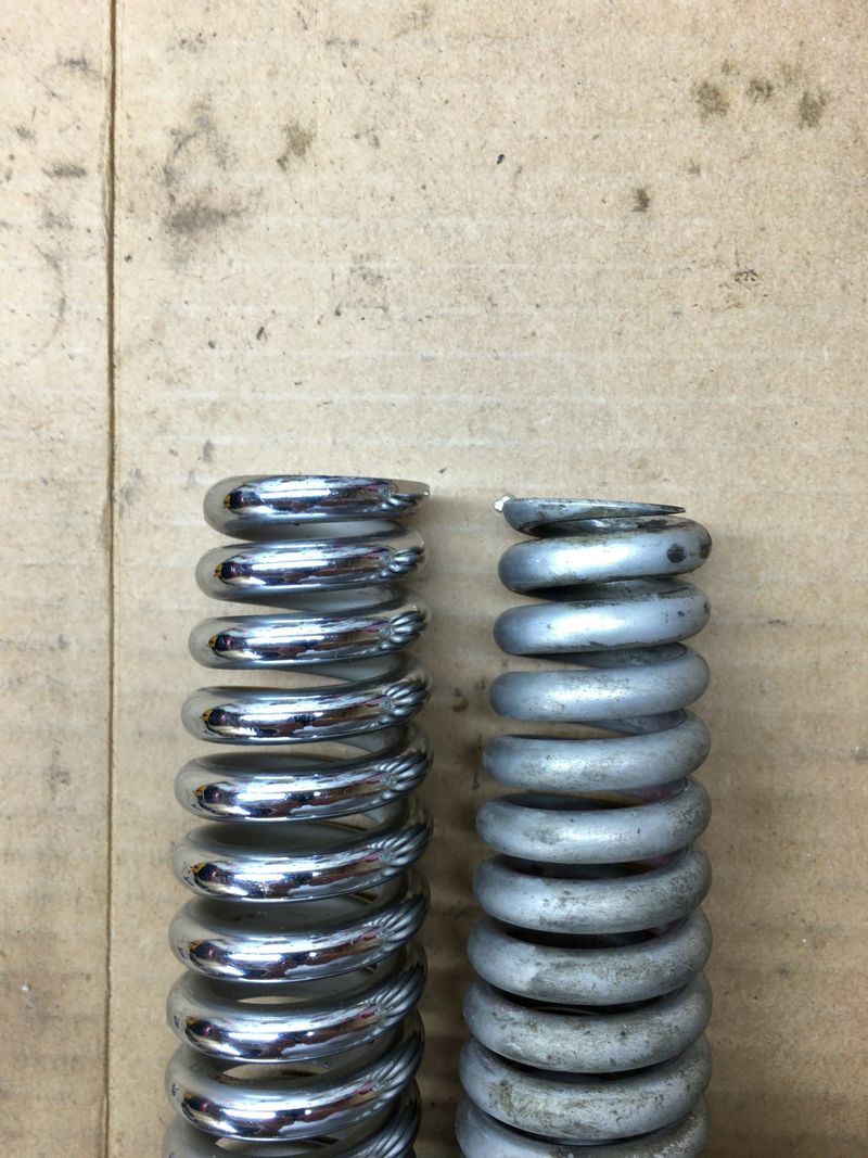

RB, can you provide where you got your spring and what the part number is? I think I found the issue with mine. The replacement spring I got is about 3mm wider at the bottom so when the swing arm moves down, the spring wants to push the bottom of the spring backwards and that is what tore the bottom of the spring off the spring bottom retainer and the trunnion.
Here you can see that the replacement spring is fatter at the bottom.
Here is the different using calipers. The replacement is about 3mm fatter at the bottom.

RB, just got my new spring today from Scooter Speed and the spring fits perfectly! It was just as narrow at the bottom as the original spring was. It was real easy to install too. I figured out the easy way to install it. I had to install a new lower spring retaining washer and I also had to put 2 washers under it so I could twist the spring on to it far enough (close to one turn with the washers but only 1/4 turn without). Then I turned the top retaining washer (with the the threaded stud attached) into the spring so the stud does not protrude beyond the end of the spring (3 or 4 full rotations). Then push the spring into place and using a screwdriver, back out the top retaining washer out so that the threaded shaft goes thru the top bracket. Then tighten the nut and you are finished. Very easy and the scooter rides great now and I do not have any clunking. The spring does touch the fork when the swing arm is in the bottom position but it moves away from it as soon as any weight is on the wheel. I am sure that the spring is hitting the fork if the wheel drop into a hole but it seems to work just great on test ride I took.
Thanks for the tip on which spring to get. It took me three tries but I finally am happy with it now.
