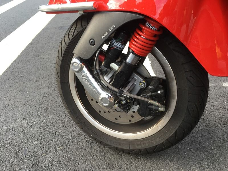

I've the same set up as your bike but I put a 4 pots Brembo at the front disc.
The Brembo brake adapter allow the shock to flip the other way around.
What's your setting for spring pre load and damping? I haven't got the time to play around with it yet.

The Brembo 4 pot is gorgeous. The breaking power is a lot higher and less effort with the fingers.
Space is tight but ok. The mechanic put 3mm spacer to offset the front wheel to the right so the breading hose doesn't touch the rim.

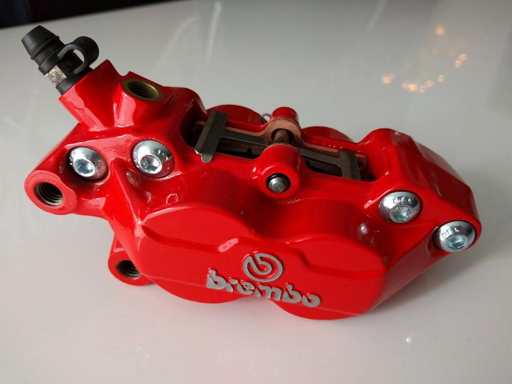

Beats me why Brembo supply their calipers with the bleeder valve down below the hose banjo. They should be swapped around. Then there is no need for spacer washers, and bleeding is more efficient with the valve at the top. With the bleeder below you can't get at any air bubble at the top of the calipers. Vito's scooter has them the correct way around.
I received my Bitubo shock this afternoon, from SIP. So this weekend I shall be fitting the Bitubo and the Brembo calipers. Looking forward to better handling (especially bumps) and better braking. Still not decided whether I will fit the shock the other way around, as Vito has it. Looks very neat that way, but a little difficult to adjust.
Mike
