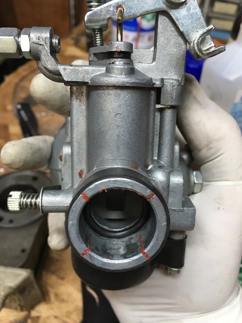

Rode the scoot around on Saturday. Ran great, but after fully warm you could definitely hear some racing when returning to idle.
So I had another go at it yesterday. Tried an old moped trick that I used to use on the Polini SHA carbs. I used a rubber o-ring inside the mouth of the carb, which would push against the inside of the intake, and I used another, larger o-ring in place of the felt washer (which I could not find) at the end of the intake. You can see in the photo the inside o-ring, and also see that I attempted to use this stuff called "wrap-fix," non-adhesive tape that adheres to itself when stretched, to attempt to wrap the outside of the carb to better seal it. That would have worked great but unfortunately, it wouldn't fit underneath the sleeve on installation, even a single layer, so instead I smeared some white lithium grease around the outside of the carb in an attempt to further seal it up.
Took it for a run around and it wasn't racing at all. Although I will need to run it harder and longer to tell for sure. A carb cleaner shot at the carb mount was the best it has been so far.
My understanding is unless you want to replace the carb and possibly intake, you're going to have to settle for a tiny bit of air leaking from this stock setup, correct? I figure my gf can ride it around town and if she ever rides it hard enough to seize it up, I'll just build up the engine then Laughing emoticon
