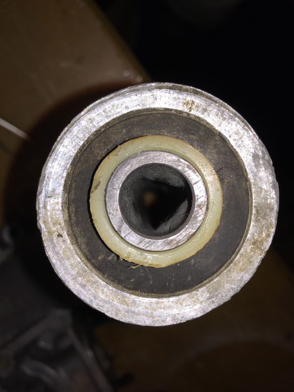

I have a vespa 50, 1966. There is a shaft that has a triangular inside and is going thru all the way in the swing arm with two rubber bushings on each side and a plastic spacers.
Question is that I have to get it out and if I can replace it with something easier to fit than that long shaft?

It doesn't look like it needs replacement

Why are you trying to remove it in the first place? Do you have the long swingarm bolt that secures the motor to the frame? What material is on the inside of the swingarm bushings that make that triangular shape?

It looks worse than the picture. Other side is not centered.
Im doing a complete engine restoration, everything is apart. It's easier to change them now when having the engine on the bench. It's a pipe made of steel. It's some rust on it. Wonder if that pipe with triangular inside is just on earlier Smallframe models. I was hoping the replacement from the link is compatible. Looks easier to fit two separate parts and get rid of that long pipe.
Yes I have that long bolt that is going trough the pipe and attaches to engine

Hopefully this helps give you some ideas how to draw out the old bushings. If its a bitch and theres room, get a small drill and drill into the rubber in various spots to help alleviate pressure on the inner tube.

I get your point about replacing them, as the engine is out of the frame. Like others they really don't look that bad & like I said it's a mother of a job. Had a look on SIP and they sell three kinds from £22 to £40 per set & this one
http://www.sip-scootershop.com/en/products/rubber+engine+mounting+bush+_11220500
fitting the tube is relatively easy, its fitting the bushes thats not so easy. You need to sit the bushes in boiling water & use a threaded rod with large washers & nuts to draw the bushes into the engine.

I just bought some BGM ones (they are harder on one side to compensate for the Vespa engine not being centered) and removed the old, installed the new. I used an angle grinder to cut the end off the long tube (they are splayed out to stay in place) then punched the whole thing out with a hammer and a big punch. Installation was opposite and I used some soapy water to get them into place then used the swingarm bolt to hold them in place for a day or so so they would assume the proper position. Here's a link for the small frame ones, good luck:

Yes mine was the stock long tube. Piaggio peened the ends from the factory. Take an angle grinder and cut them off....the BGM bushings are two piece and two tube instead of one and meet in the middle.

I've had good luck using a flat head screwdriver to get in between the outer rubber bushing and the swing arm, pry it away a bit, then squirt some WD40 or other lubricant in there working my around the whole bushing. Then stick the flathead in through the center hole and try and pry/wiggle the whole thing out.

Just got them out and it was super easy 😊.
No scratches no damage only wd40 and a screwdriver.
5min job. They are making themselves a bigger job than it is in the youtube video. Happy Im replacing them, rubber looks like crap.
