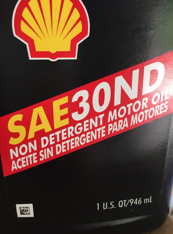

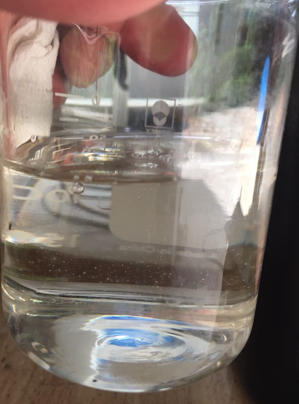

Guys, does this look right?
The color is clear like water
Thanks

Come to think of it, I don't think I have ever seen water-clear oil except mineral oil maybe. Does it have the viscosity of 90 w gear oil ? Should be the same. I'd smell it. I smell everything, much to the chagrin of my brain cells.

Not much of a smell
Posts: 8370
Posts: 8370
I don't know, I think you should try another bottle or brand. How does it feel between your fingertips? Watery, oily?
1980 P200E - GT 200 L - 2005PX150
Posts: 492
Location: Florida
Posts: 492
Location: Florida
Oily

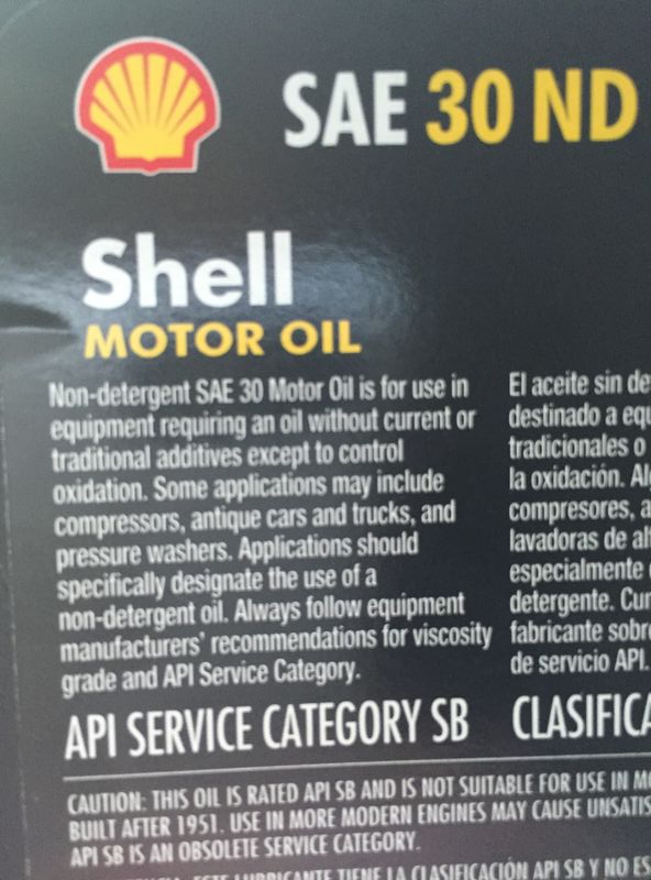

Hydrotreated ?

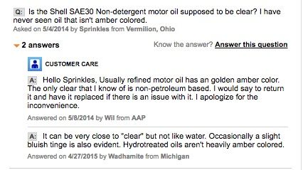

Found this today.
Posts: 8370
Posts: 8370
There you go. Razz emoticon

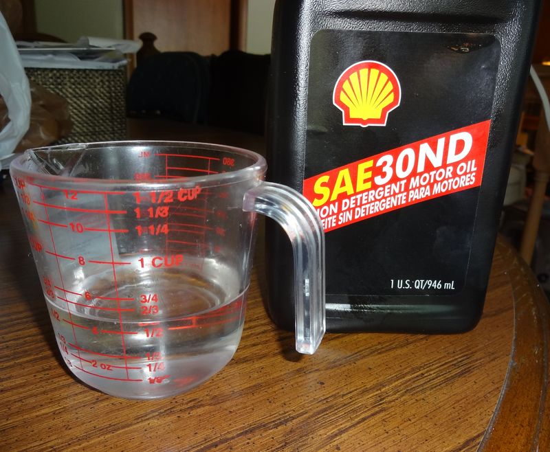

I have been using the Shell SAE 30 ND oil for some time and it does appear to look like water (see attached photo). But it does have viscosity. I went and purchased a quart of the NAPA premium SAE 30 non-detergent motor oil ($3.99) and it has about the same viscosity as the Shell. It does have a slight amber color to it however. I have no doubt that the Shell SAE 30 ND is very similar to the NAPA oil. Both oils are rated as API SB. Use either in the vintage Vespa gear box and ride on.
