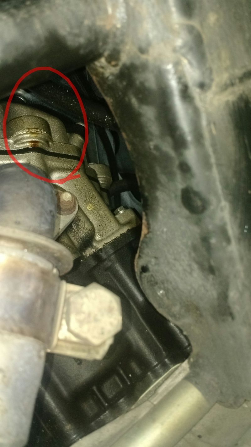

OK so i found this leak underneath the bike today
