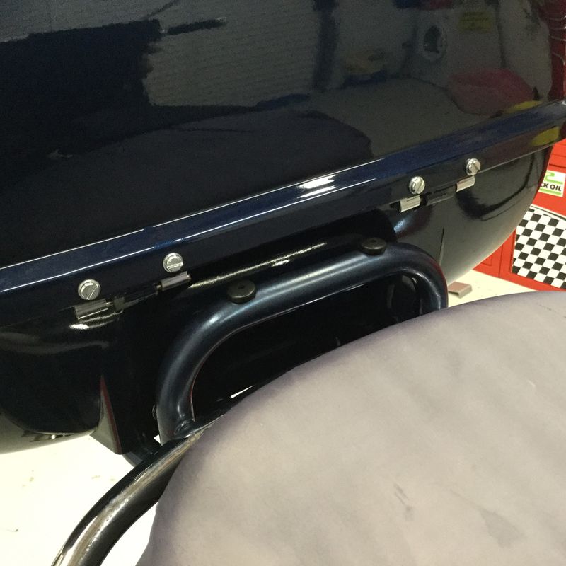

You inspired me to fix mine ready for winter.
It's better than the original cheap hinges.
Thanks for the inspiration

Awesome Shreevsey! They are looking really good!

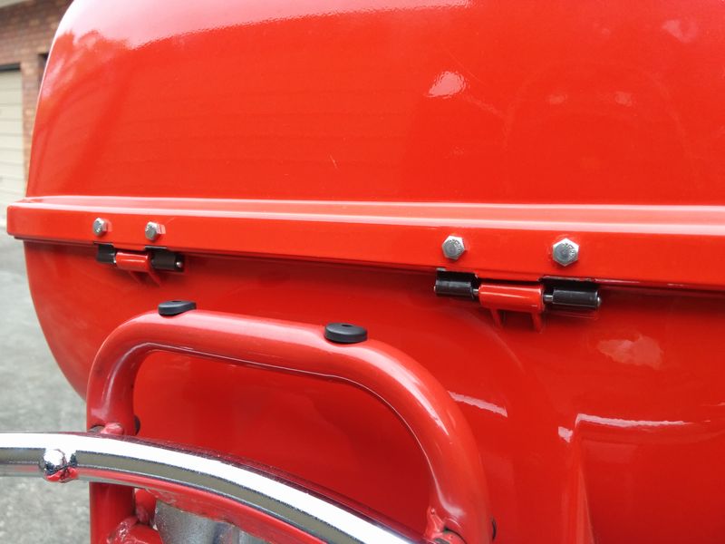

After some lovely help from Steak (thank you), I repaired my top box too. Parts cost under $20AU... So much cheaper than buying a new top box at $400+AU.
I had all the tools so didn't need to buy any. Most useful were gripping pliers and a decent sized bastard file. Also a saw to trim the bolts.
Didn't use washers, but bolts with self-locking nuts. Will see how these go.
So far one of the pins keeps vibrating out, so have put some liquid nails glue on the end, will see how that goes too.
Feels great to finally have my top box back!
Trimmed some of the bolts too short :/
