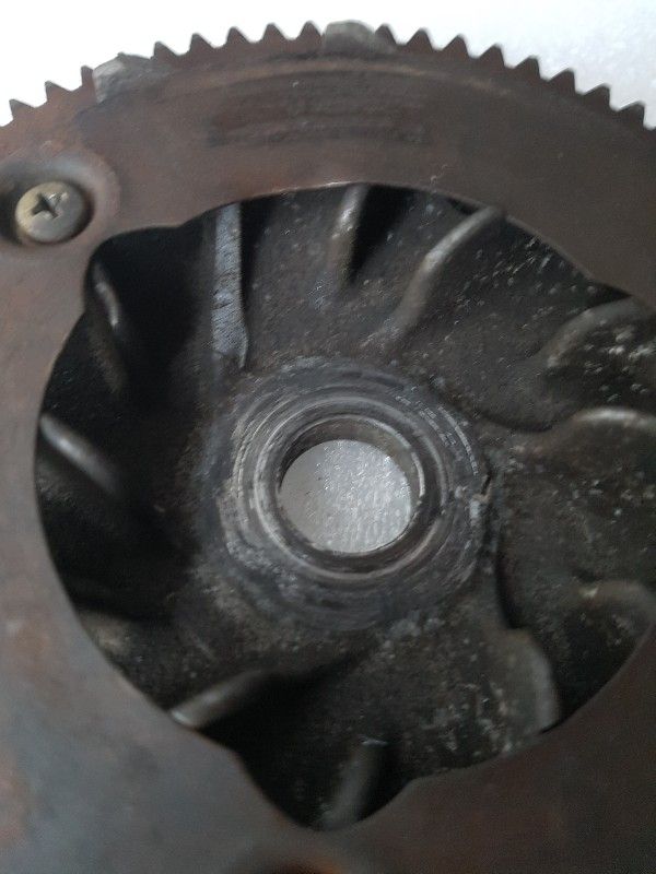

So got my piaggio x8 running finally , was the Bendix , now it's bogging down when revving , idles very well.
Noticed half pulley is smooth where the spigot goes in, is this normal or does it need to be grooved

Is this the outer variator pulley (the 'driving' pulley) that has the starter ring connected to it? If so, yes, it should be splined. If the belt had previously broken catastrophically, it's not uncommon for the soft aluminium splines to get shredded when the belt jams.

Should have part coming today in post I think this has caused most of my issues of bogging down when revving.
Cannot believe I didn't realise it sooner

Right gents need serious advice think I have a major problem with the x8
Just got back from attempting to sort my scooter out after thinking it was the Bendix,
Well I'm back to square one,
Pulled the brand new variator pulley out which is days old, totally shredded again in the middle along with a brand new washer(outer) which is days old too.
Exact same reason before, what am i doing wrong am i torquing too hard (impact wrench)
But previous seller didn't have said wrench, and had exact same problem.
Splines still look good .
Pulling my hair out.
Looks like I'm going to have to buy another pulley and washer.

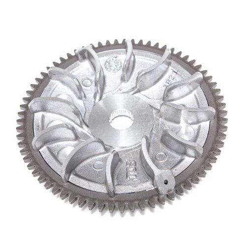

If you are using the original variator, and it's an old leader bike, you might be using the wrong outer plate.. The original outer plate on the Leader Variator looked like the one in the photo, and we still see them on some old ET4s with the leader engine. We never got the pre-leader engine in the US, so I'm not confusing the two engines. If you have a TGB variator, the build date is probably stamped on it somewhere.
Whenever we put a Malossi or new Piaggio variator in the bike, we have to change to the new variator plate, which looks like the one you have, because the old style will rub against the variator cover. So if you have the early variator, it could be that with the new plate, you can't really tighten it down, because the splines are stopping the nut, but there's play in the variator.
I've got a couple, and SIP sells it, (they are closer to you) here is their link, with the OEM part numbers.

Thank you I will try that one as the other two have been identical which have chewed.

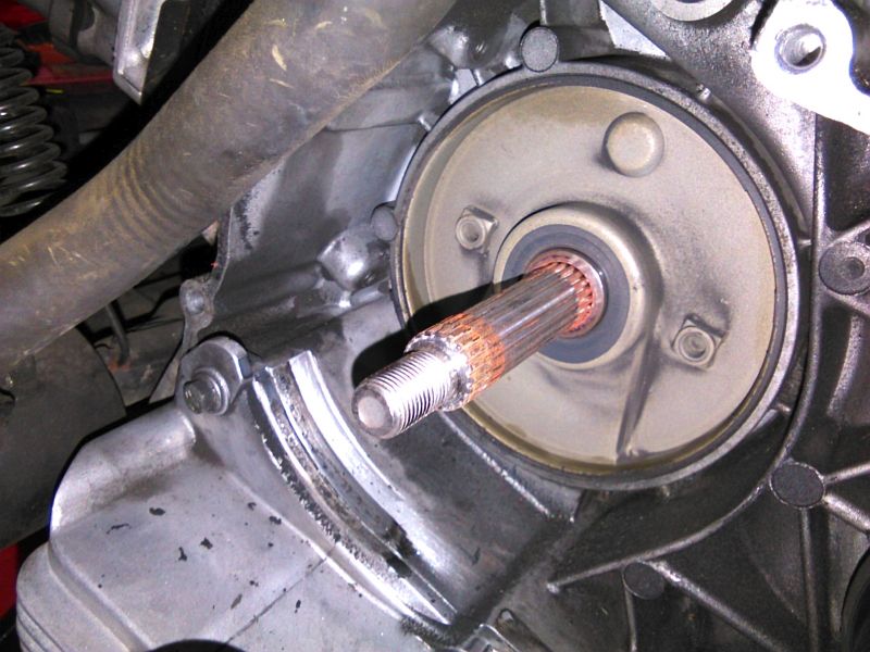

Checked my splines throughout and basically there is slight play in and out a few mm on the clutch one is this normal,wheel obviously spins.
On the variator spline, it goes like this __-------__ weared in the middle .

That extra machining in the middle is absolutely normal - do not be confused by it.

Are you sure getting worried now the scoot is a write off
Every Vespa/Piaggio crank I've seen has the middle thinner. Here's mine on a GTS300 - different engine but same machining on crank.

Thank you for reasurance
