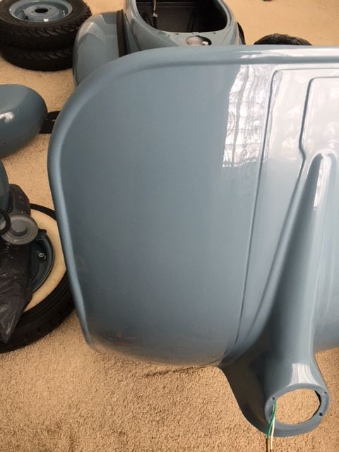

I gave my vbb 2t for paint and the paint guy filled up the holes with bondo. can someone please send me measurements from the edges for the holes for a 1965 vespa vbb 2t
Vespa 150
attached is a pic
thank you in advance.

If I may suggest.
Attempting to measure the distances from radiused edges will get you close at best.
Try sending a "Rubbing" of the badge/rivets/legshield trim.
The back of a spoon or side of a closed end wrench works great.
Then you can tape it on and transfer location points.
I have a 61 VBA, Are they all the same, and in the same location?
I can send you my layout.

by the way, I need the measurements of only 2 or 3 holes from the edge.
I want to drill out only the bondo not the metal sheet. I want to be as close to original as possible.
thanks in advance.

this is what my scoot looks like.
PS: please note new continental tires in the background and whitewall tires too.

I do have the decal with the holes. I want the exact holes in the body. I can transfer the holes from the decal to the body but want to know where to start. wheres the exact location of the decal.

ok,,,
the hole at the bottom of the V is 40mm in from the side of frame and the hole on the number 1 is 100mm down from the top of frame edge.

hi josh,
I need one more hole please. right now I am drawing this on a piece of paper and it can be different positions.
if u can provide the bottom v hole from the top, that would be helpful or the 1 from the side
or provide both holes from the top and side.

from bottom rivet of V to to corner directly up 120mm
