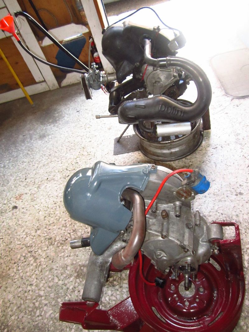

Done almost EXACTLY this on two bikes that were originally a 50S and a 90. The 50S got a used Primmy crank and both got stock used Primavera 125 2 port top ends matched to the cases*, the 90 got a used 4 speed gear set and the 50S got 90/100 primary gears. Both have decent pipes and are running 3.50 tires on the motor for a slight 'upgear'. One has a 19 carb plus reed valve and the other has a 20L.
Either one would deliver all you are asking for and more with good reliability and reasonable cost. If you go this route, I do like this idea and think you could do it nicely with a little effort & luck.
ThomasHSB wrote:
Hell, I'm the asshole that'd just take a hole saw to the cowl where the plug winds up. It's just steel.
*More here on matching the cylinder to your case where you can see both motors being built: Cannot recommend...
