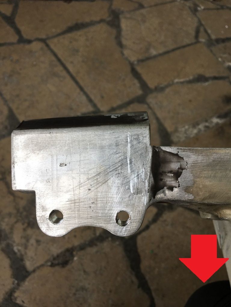

whodatschrome wrote: SaFiS wrote: whodatschrome wrote: Is that some sort of optical illusion that I'm looking at in the last pic? to this? Doesn't look like casting porosity... Regardless, JBWeld & paint will fix it, that's never gonna break off. |

Don't think it was something serious. Just 2 - 3 pinhead sized pores. My father told me that when our machinist was welding the plate, he had small bursts from the casting. Probably impurities or trapped air in the casting. I had the same problems with my engine cases when we beefed them up for the Malossi...

Cleaned up the excess JBWeld today and took the parts to the paint shop...
I preferred JBWeld instead of bondo to cover the pinhead sized pores... Updates to come... |
