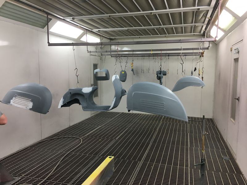

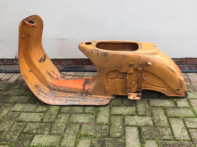

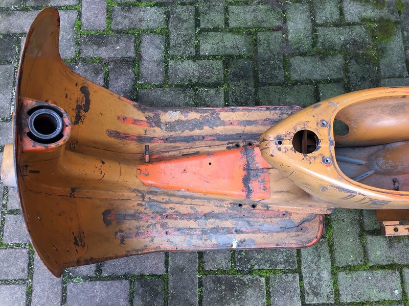

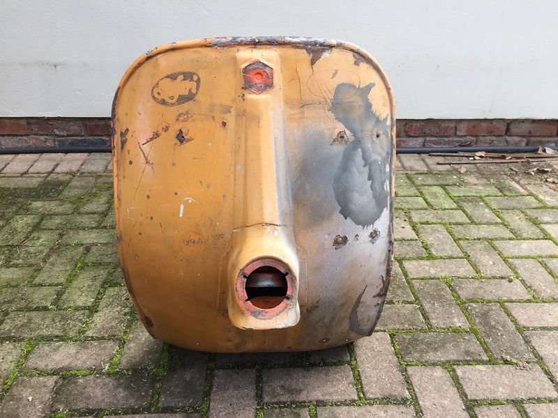

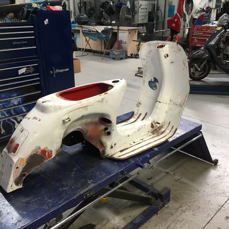

Picked up this 1969 Rally 180 that had been in a shed since 2002. No real rust, just surface rust, a few stress fractures but pretty straight and very much needing to replace a dodgy paint job.

I'm feeling the airbrush job on the tool chest where the lighting turns in wrenches. Kinda next level. The scooter looks good too.
Posts: 10121
Posts: 10121

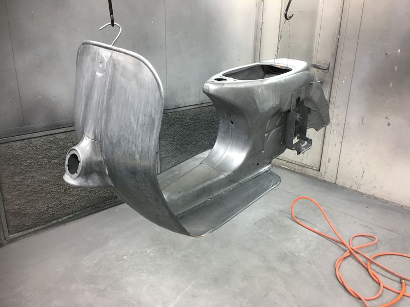

Great prep, looks like bare minimum of filler. Nice job on the cowl & frame looks dead on - paint remover, wire brush, media blast - what's been done.. ???
Actually no filler at all was used. Body was very straight and only a little surface rust so after soft welding a couple of stress fractures and metal filling a couple of holes that should not have been there it was good hammer work only to straighten out the dents.

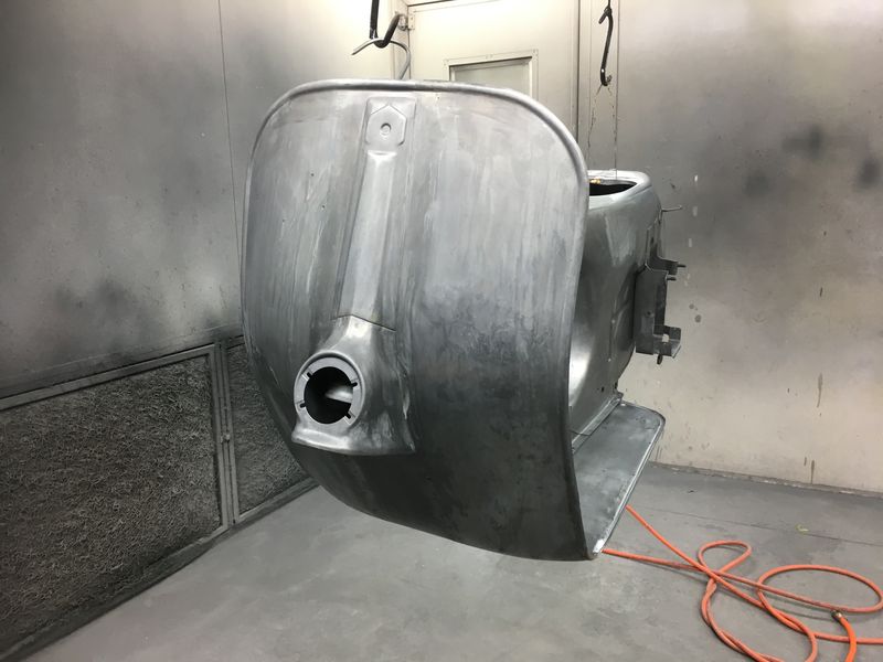

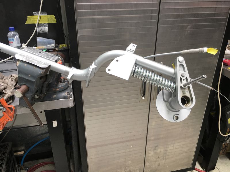

Thanks V oodoo. As said frame was in very good shape so banged small dents out, had to soft weld some stress fractures, then dipped to completely remove old paint. Rust proof primer applied so the frame can sit and wait for the engine rebuild. I am going to keep this pretty stock. Even after 15 years of sitting in a shed, with a little coaxing we got the engine running which was lovely to see / hear.
@capsurfer avatar
Vespa 2018 Sei Giorni & 1969 Vespa Rally 180
Posts: 90
Location: Sydney, Australia
@capsurfer avatar
Posts: 90
What hasn't been done yet and will be a little fiddly will be straightening the grill bars on the engine cowl. Plan to make some wooden templates to try to get the right edging. Couple of them had been a bit bent.

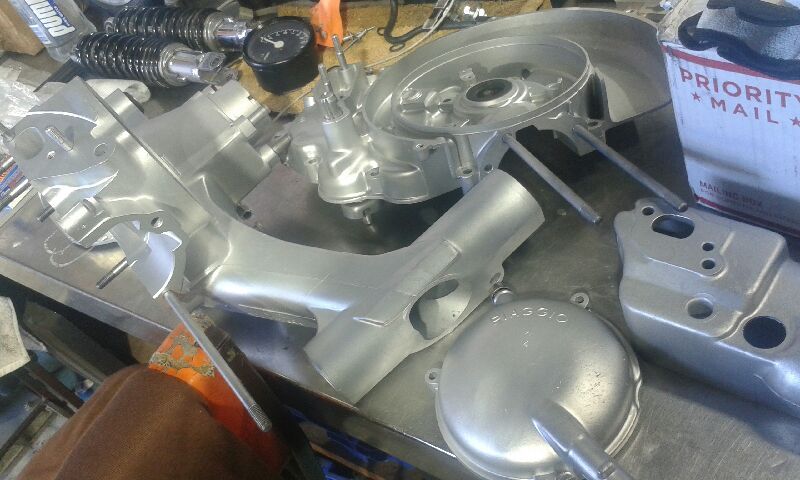

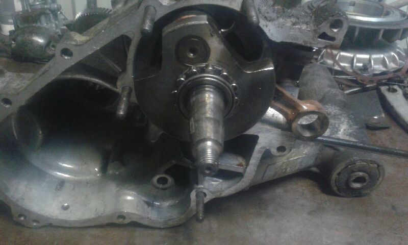

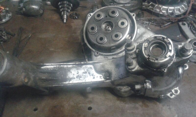

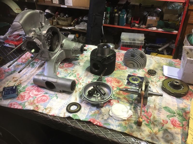

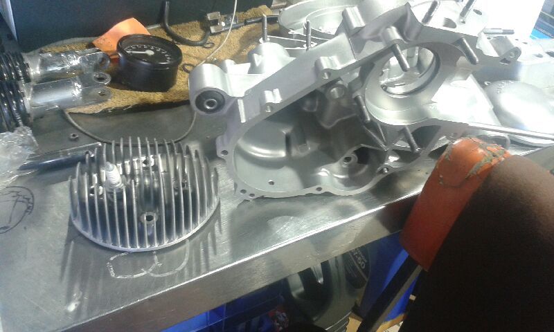

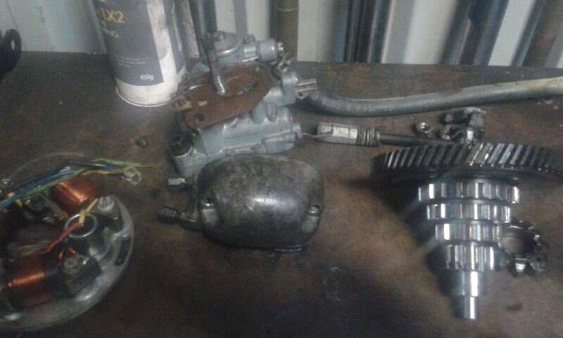

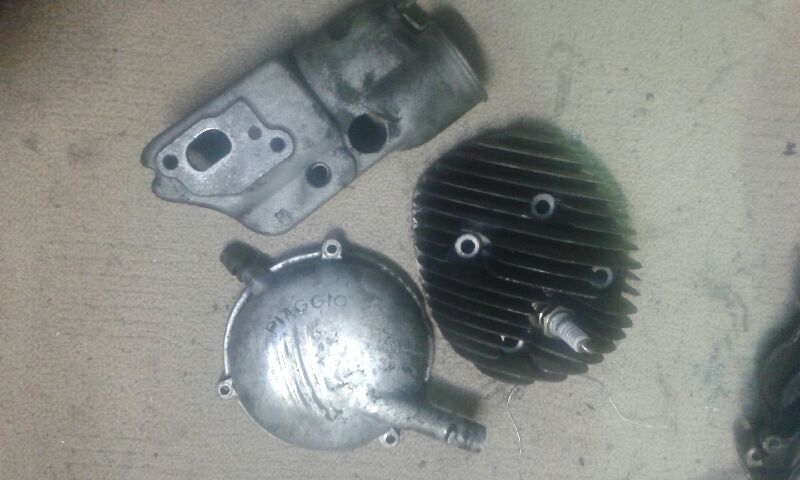

Engine stripped down
More fun!
@capsurfer avatar
Posts: 90
@capsurfer avatar
Posts: 90

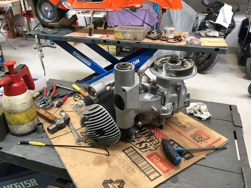

HydroBlasted
Some engine porn

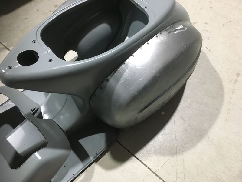

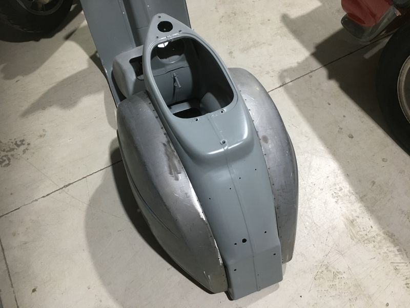

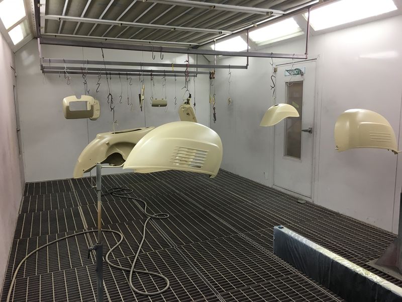

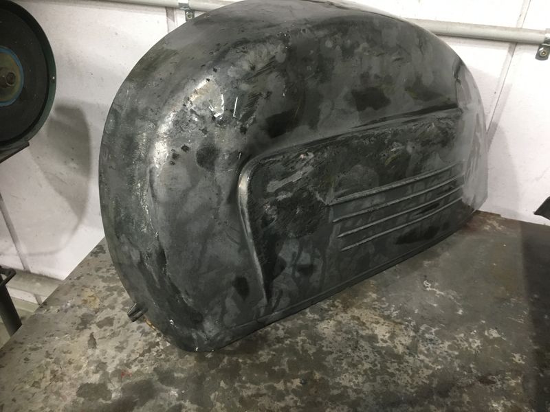

Replacement cowls
Thought the cowls were going to be ok but had been distorted too much so bit the bullet and bought replacements. So happy they fit perfectly.

I'll take that as a positive comment 😂 . Really couldn't get the cowls to line up tight against the frame so didn't think I had an option other than to replace.

it was ...
They can be a bit of a bastard like that. But yeah, you gotta do what you gotta do. And by all means making stuff easy can be as simple as forking out and doing that.
Stretching them out to fit...Just bully the bastards to fit flat by hand then bang at them with the wooden mallet to get the shape back...try it now if you can be arsed...a couple of layers of masking tape on the primer where you might scratch it up. Put it on, check the gap/fit, pull it off and just twist and mutton it flatter and put it back on. Takes 1/2 and hour and itll sit flat to the frame. Dinging the dings...well thats just dinging the dings, either you can do it or youre a bogger.
looks good so far...did you acid wash the bare body?

Hey Trumpy, spent some time twisting and banging but to no avail. Now that I have bought the replacement I'll leave trying to straighten the originals to a rainy day.
Acid washed the body before priming. Liking what I have got now so looking forward to getting it sprayed.

Engine pieces
All the pieces looking schmick, just have to put them back together and get the carby sorted.

Nice project, that engine looks brand new - wish I had done that to mine now!

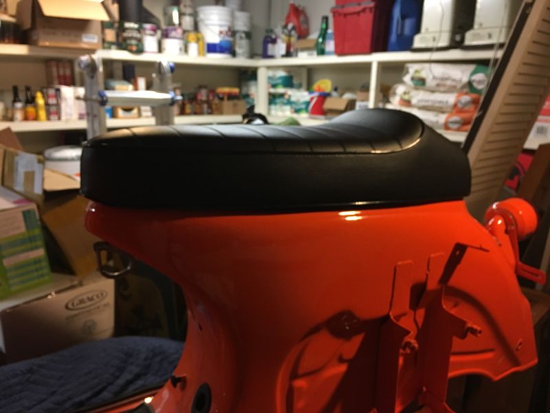

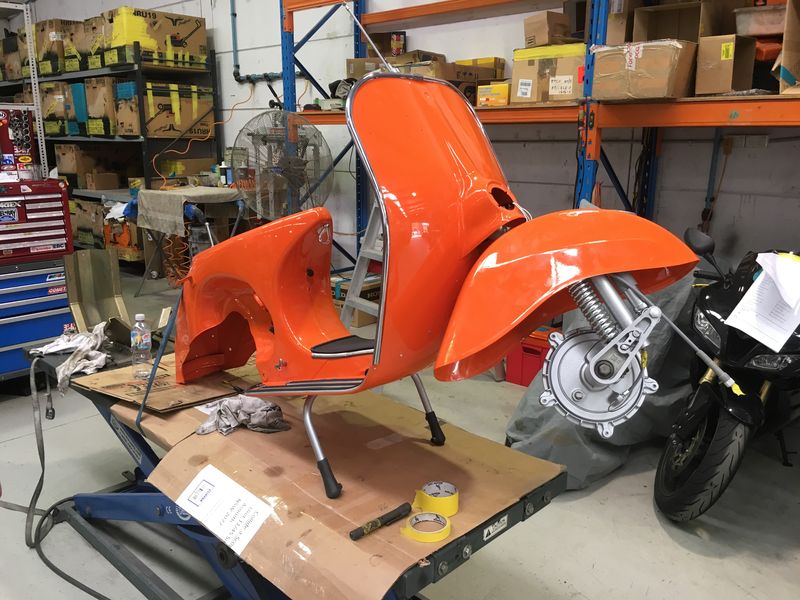

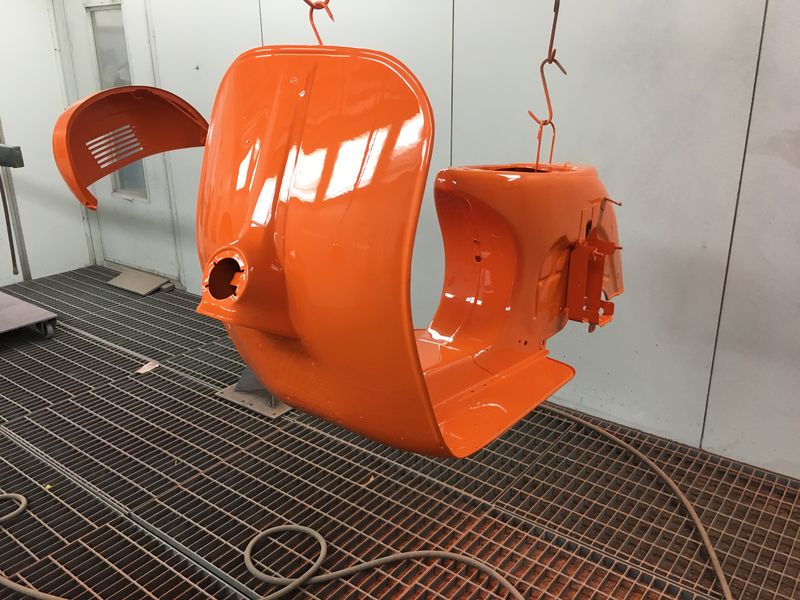

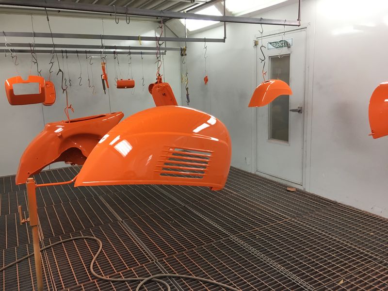

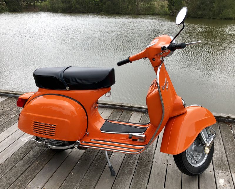

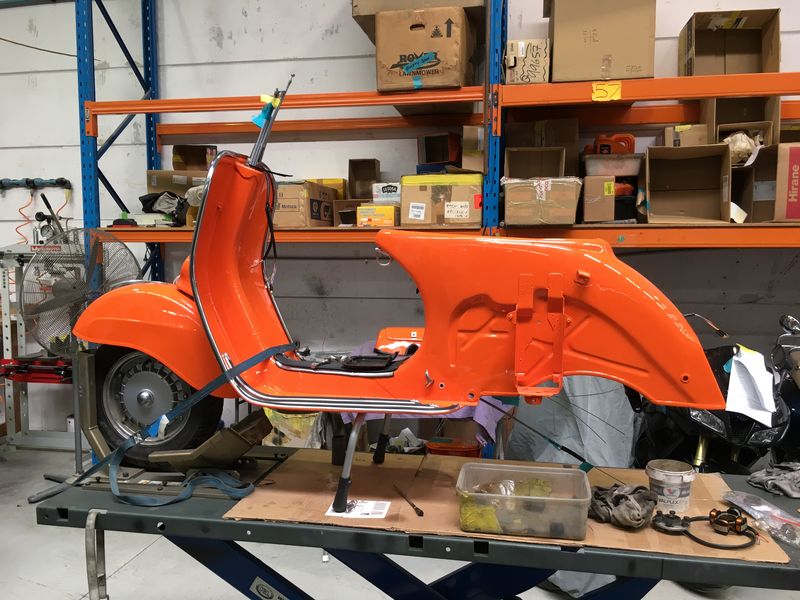

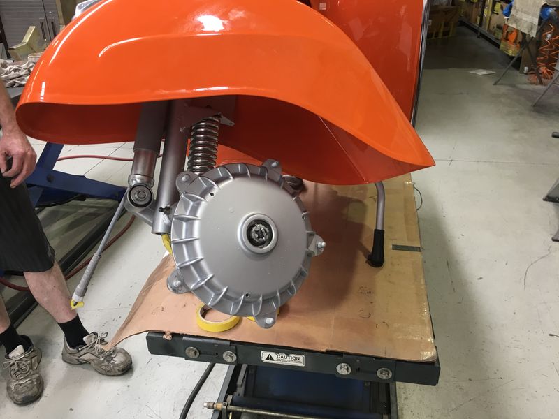

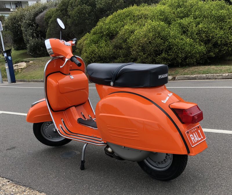

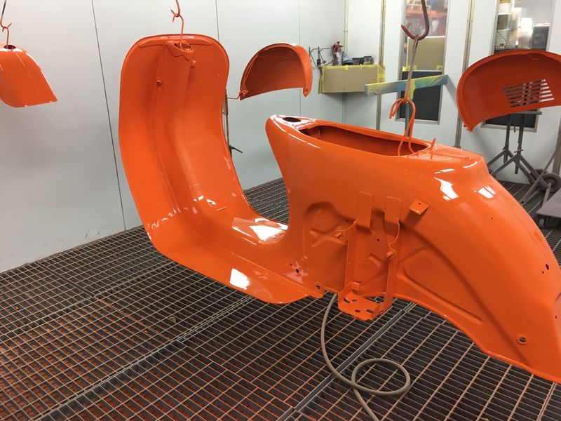

Rally 180 restoration project update
After a series of delays we have some progress

Wow!

the paint look orange wow

yep! Trying our best to match the original colour of 1969

Looks spot on to me

beautiful. great work. 8) Clap emoticon

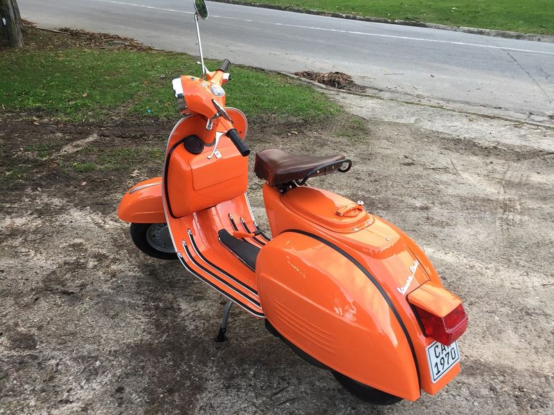

Hi Capsurfer. You reminded me of my own 180 Rally project. A couple of years ago I bought some Vespa bodies and engines, and among the engines was a 180 Rally engine. It took me 3 years to find a 180 body! Anyway, this is how my 1970 model looks today.

nice job Danie

That is a fantastic restoration job Danie, well done! Hope mine can look as good.

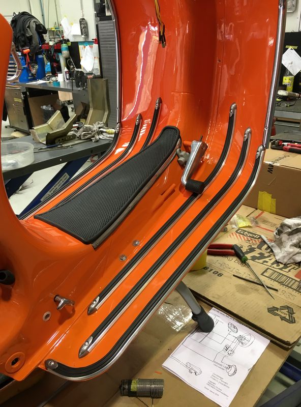

Thanks, getting close now.

I think the end result will be the same. However, my engine was not that clean!!
