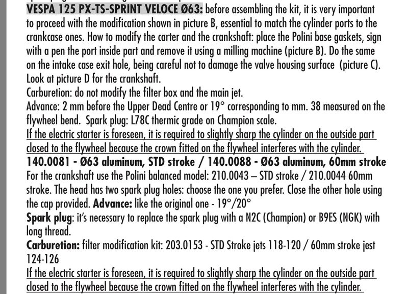

If it is similar with Polini, the cylinder bottom could interfere with the starter ring. According to Polini manual it is saying that you need to cut the bottom of the cylinder because it interferes with the starter ring on electric starter models. Please find at the attachment.

Additionaly, the clutch sensor cable on the left hand Side could be broken.

Did you cut the bottom fin off?
Check the studs have not screwed in too far.
Both these can cause interference with the starter motor teeth
