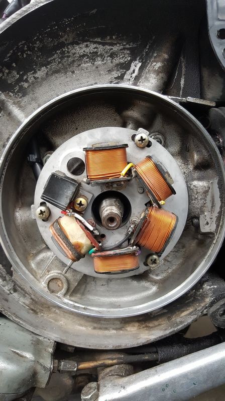

As a point of reference, this is a photo showing the stator alignment after I had the stator re-wired. My stator doesn't have the typical line markings I see in most photos; it just has the one line which I lined up with the engine case. I have posted this in another thread before, and pretty sure this is at least close to correct (factory?) setting, which I understand may not be exactly accurate.

My stator in my 1980 P200 is the same way... Yep that looks like it's set on the stock setting.

The line on your stator plate really isn't useful for judging the timing, but at least you know your stator is installed the right way.

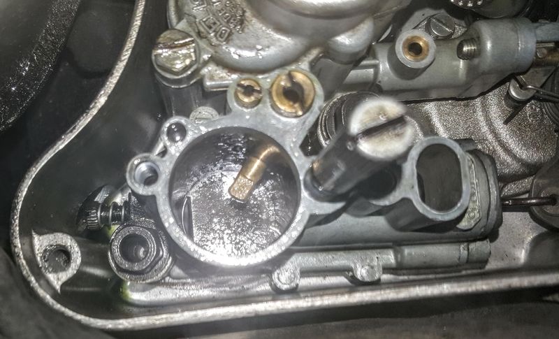

So here's the shot down my carb. That's really all the space you need for idle; just enough to see the notch in the slide. If you open it past that, your idle mixture screw won't have much effect if any. Idle mixture should be about 1 1/2 turns out from fully closed.

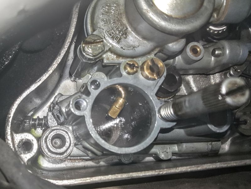

And also (just as an example), here's where my stator sits for proper timing with a p200. As you can see, the lines are in the neighborhood, but not necessarily aligned.

I adjusted my idle screw and mix screw, and I have to turn the mix screw out quite a lot - way past the default starting point.
I have attached two photos showing the settings. At the moment, idle is very low but steady, although when I started it up cold this morning it was stalling for a while and bogging when I revved it. Then there was a backfire, but since that, I rode my usual 8 miles to work and the bike is running smoothly, accelerating smoothly, no stalling at stoplights.

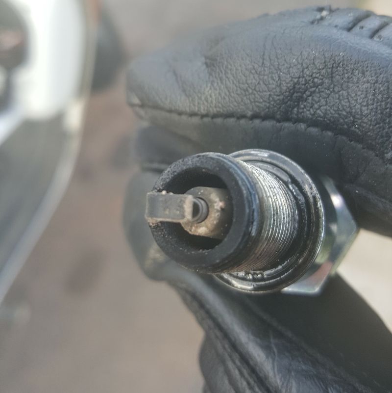

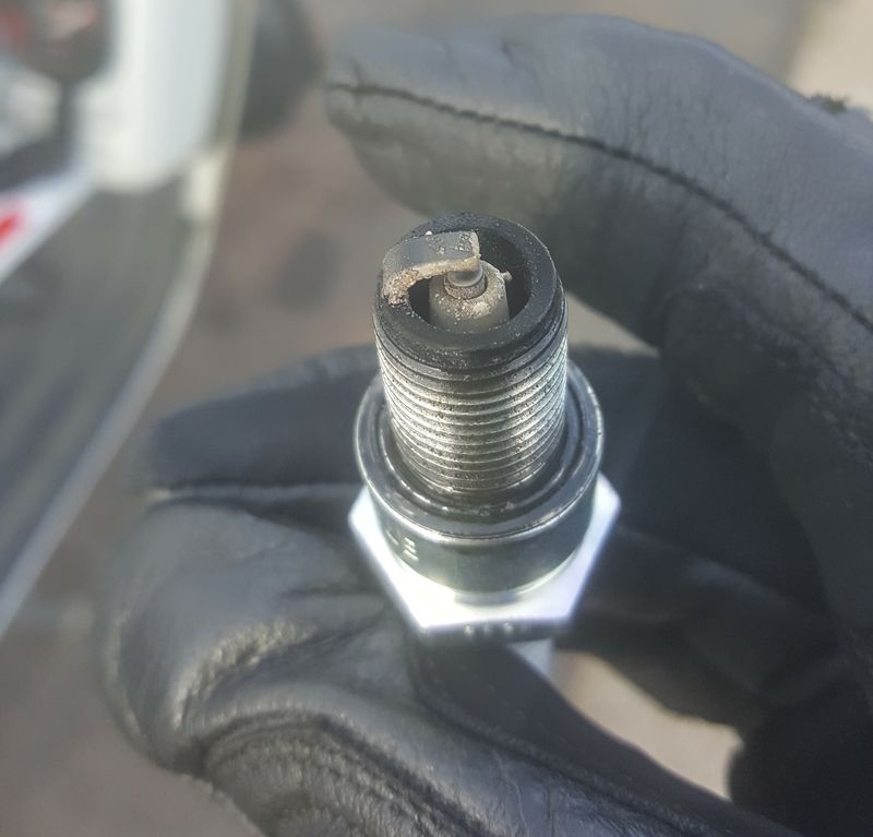

Then I took it for a ride and did a plug chop in 3rd gear and have attached photos of the results. Color looks normal, but I do see some deposits. Still, it doesn't look much different than the "normal" one posted on the NGK website.

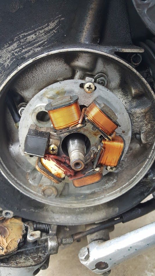

Something I noticed while browsing through my photos - the attached photo was taken before I removed the stator and had it re-wired. From the placement, I can see that I have the timing slightly more retarded from where it was originally, based on the gaps where the screws mount. Wish I had captured a better angle showing the alignment marks on the bottom, but I was not even aware of them yet.
How the stator was mounted before I removed it to have it re-wired.

Are you strobing it at idle or revving it up? Since you need to rev to get the degree to move to where it is really going to be. Not at idle..
Mine moves 3-4 degrees it seems from idle to 10-20% throttle and above.

Strobing it at idle.

Plug chop: called a plug chop because you must cut a brand new (ridden only at the throttle setting and motor loading being investigated) and look at the base of the insulator. Try Google.

The marks between the flywheel and stator aren't useful references, so having them line up when strobed doesn't mean anything.
Check the first 8 minutes of this video. Ignore the rest, as it's instructions for a points ignition.
Once you have your timing marks placed, you need to strobe it to see where they line up.
Adjusting the timing on yours means pulling the flywheel, moving the stator, and reinstalling the flywheel. You may need to do this several times to get it right. Be sure to torque your flywheel to spec every time before starting it during this process. Failure to do so can damage your crankshaft keyway.
Best,
-Slashy

Thanks, I think I understand now...I'm creating a new reference point by degreeing it myself.

Also, consider lapping your carb base on a sheet of glass with some fine wet/dry sandpaper because I also had an issue with this at the same time - carb base was warped.
I do that every time I fit or remove a carb. These aluminum units warp very easily, and lapping them for safety on flat glass (I use part of a 1 inch thick marble mantle found in the street) makes sure your carb is installed properly (in that respect, at least).

re: carb - Yes, I did check for warping and gave the base a light sanding when I rebuilt it last year.
I checked the two mounting bolts the other day, since re-torquing them, and they have not loosened, so I think I just did not torque them down quite enough after the rebuild.

Once the bike warmed up, at idle my IT mark on the flywheel was a few degrees forward (clockwise) of the mark on the case. When I revved the engine for a bit, the timing mark moved back slightly closer to the mark on the case.
I have just removed the flywheel, adjusted the stator plate CCW slightly, and am now re-fitting/torquing the flywheel before taking another reading. I think this is going to set it back at what it was prior to my original removal when I had the stator re-wired.

After my timing adjustment, my IT mark on the flywheel is lining up pretty much spot on with the case marking, both at idle and when revving.
I torqued the flywheel nut to about 43 foot pounds.
Also, those factory flywheel marking lines are aligned pretty well with the markings on the stator, visible through the "beanhole".
