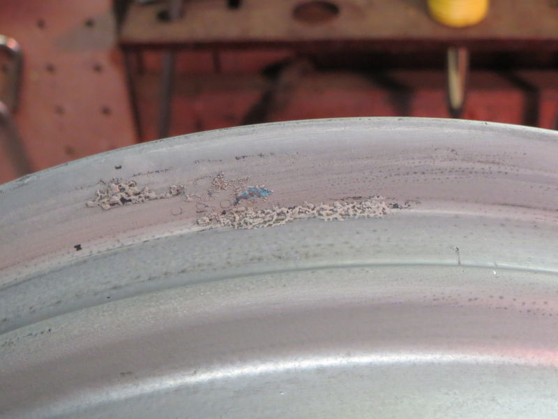

Could be a bad rim. How old is your bike? Also you might want to throw some Ride On in the tire. My tire (rear one) went through a period where it was losing more air than it should. The weather, i think had a lot to do with it. That said i threw some Ride On in it and then the weather stabilized. Both or one of the things i did worked. Ride On isn't like Slime. Doesn't go everywhere when you take the tire off. It's used to stop little punctures from making your tire go flat. I'd swap the stems out as well. Use the straight ones not the curved. Good luck
