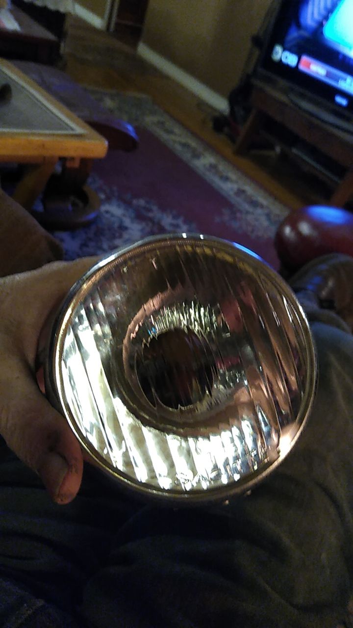

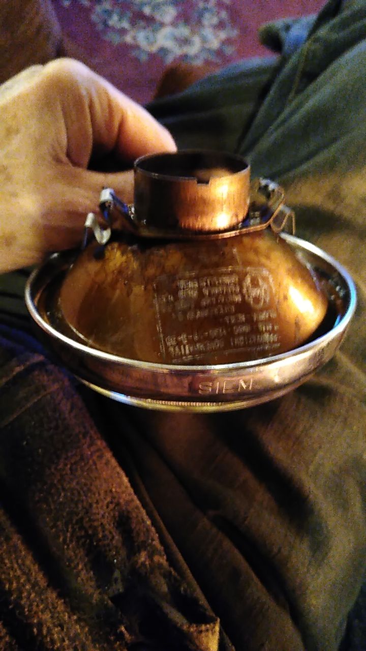

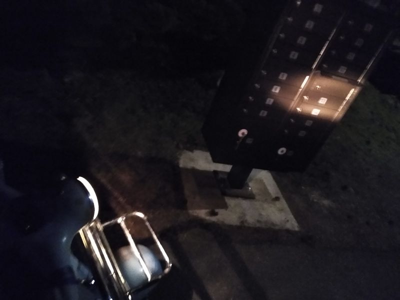

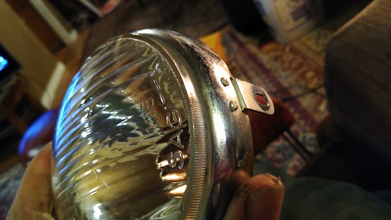

Thanks Patrick, but I found a nice reflector w/ glass lens for when I can find the outer rim to hold it all together. For now I Shoe-Gooed a plastic lens into the bottom half and a strong 12V 20W halide w/ reflector onto the headset base back so it doesn't melt the lens.
It's a big ticket here riding w/o your headlite lit up here so this Rube Goldberg setup gets me on the road safe from the cops for now. It's pretty bright and I have a running lite glued on top of that. Electrics all work good except the horn and I discovered that older AllStates require the 'battery' type of brake switch so the brake lite comes on when I hit the brakes instead of going off.

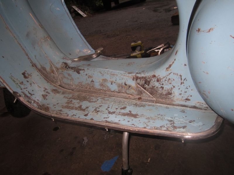

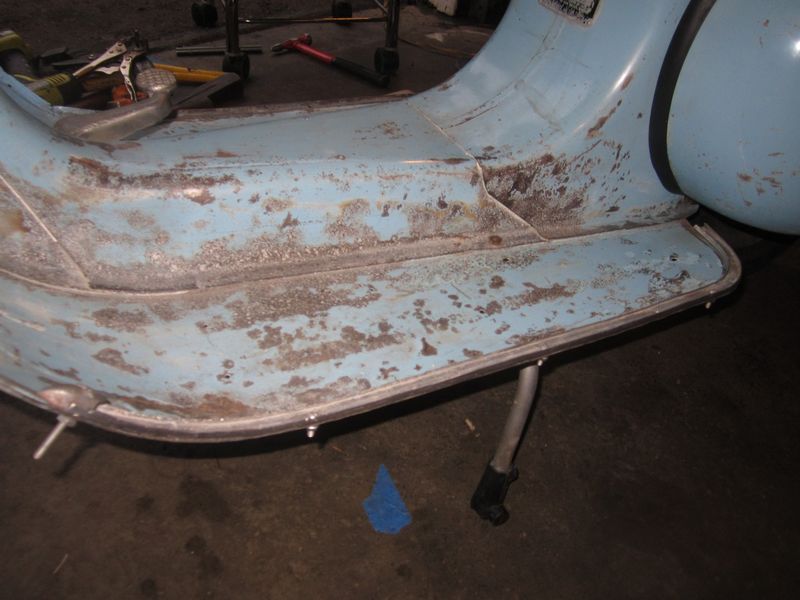

Now I'm in the middle of fitting the floor trim, but first I had to get my groove back. The outer trim has a big hump along the bottom, unlike newer trim which is flat on the bottom. To get it to fit right I first had to reestablish the groove along the edge as well as getting the edges straight and properly curved where the legshield starts.
no room for speedo until I get the early AllState rim & install proper lite where the lens is
Love that Shoe Goo!
strong resilient mounting and removable w/o a trace
Love that Shoe Goo! strong resilient mounting and removable w/o a trace
you can see how big that hump is next to some newer same size trim
and how messed up the groove and the curve are
this helps a LOT
this helps a LOT

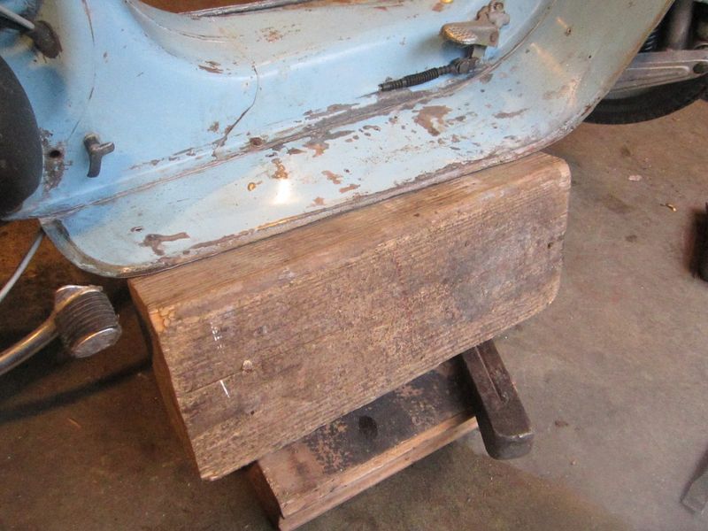

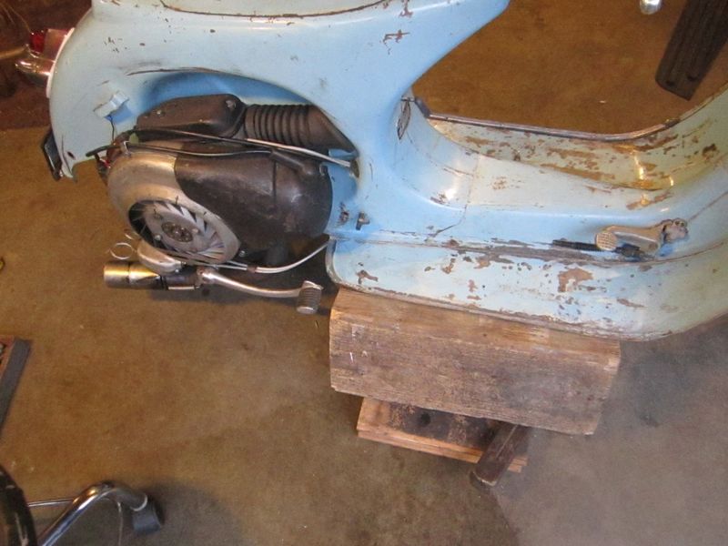

more pics
do this for a while
do this for a while
weight of scoot is on the block lifting it just off the stand
now to get the edge straight
weight of scoot is on the block lifting it just off the stand now to get the edge straight
getting there
getting there
here's the other side w/ trim dry fitted
straight and flush w/ the floor edge

primavera130, thanks but I do have a nice ~110mm reflector & glass lens that I can use when I find a used rim that will fit my headset. It's about 110mm at the front where the rim slips over it.
I don't want to use a repop or even a new Siem for this, same w/ the speedo. The only new stuff used so far are a budget performance 3 port top end and seals, gaskets in the motor and fork bearings, all cables, levers and most of the rubber on the bike. Crank, bearings, clutch and everything else in the motor & on the bike is cherry picked used.

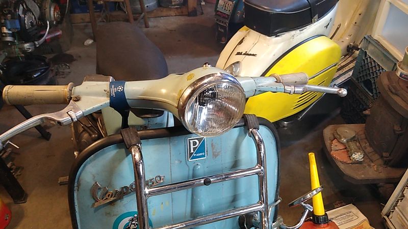

Ameribodged, big rubber band keeps headset together
Posts: 10121
Posts: 10121
Other than the goofy headset and a possible switch to a bench seat, it's about done and already fairly rideable although I'm still tweaking the motor. Still must finish the final floor rail install w/ rivets including the two center ones and the rubber strips after I clean, prep & rustproof the grooves.

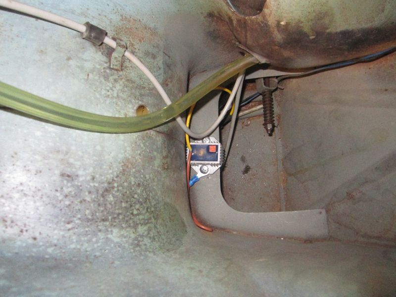

stealth voltage regulator

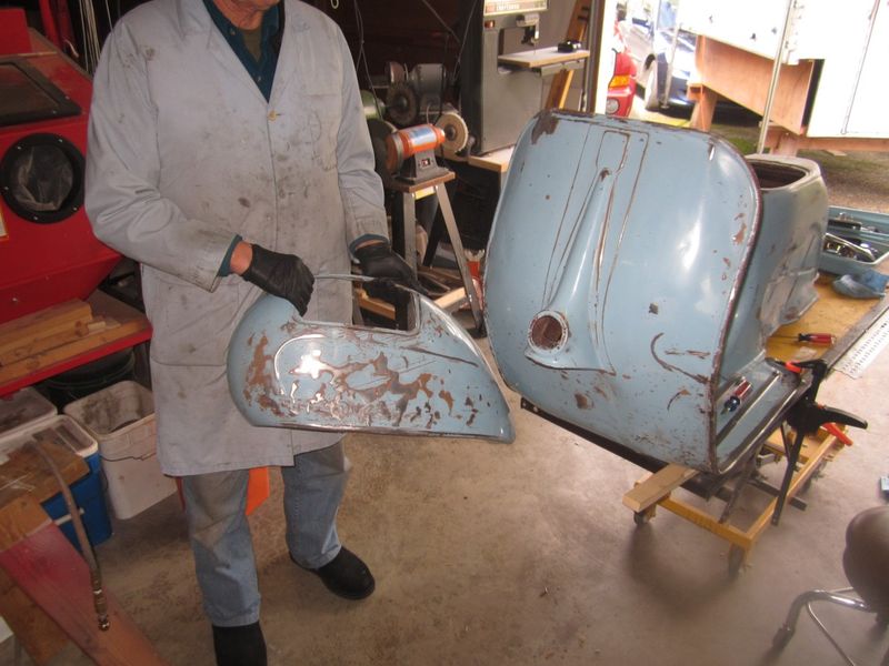

Pics from early in the day , it started raining & we started hustling so forgot to take more.

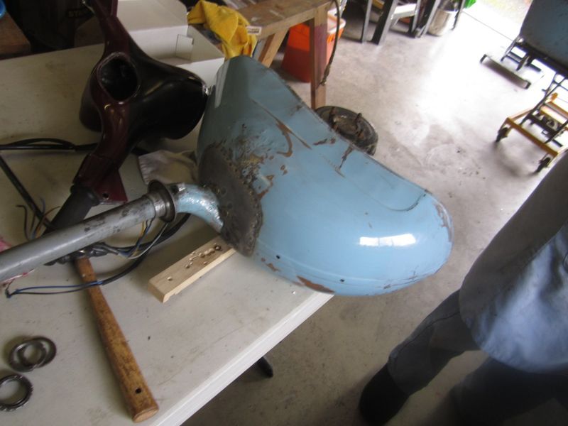

Motor and frame pretty much like mine
He scrubbed thru the blue some places getting rid of the rattle can red primer that covered it
Motor and frame pretty much like mine He scrubbed thru the blue some places getting rid of the rattle can red primer that covered it
His floor paint is good enough to get away with a full set of floor rails stolen from his VBB
In many ways his frame is in better shape
tool box cowl is about as wrecked as mine
In many ways his frame is in better shape tool box cowl is about as wrecked as mine
but his engine cowl is way better

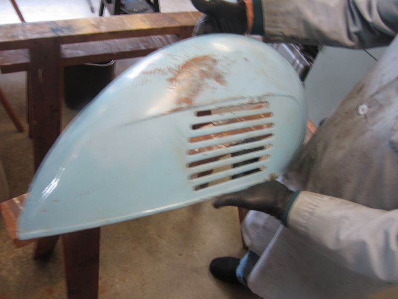

at least my mudguard beats this poor mess
this side was badly cracked so he bonded a doubler on the back side
new mounting area is spot welded all around for strength
except for 90% decent paint, this was near dead before Doc operated on it
at least my mudguard beats this poor mess this side was badly cracked so he bonded a doubler on the back side new mounting area is spot welded all around for strength except for 90% decent paint, this was near dead before Doc operated on it

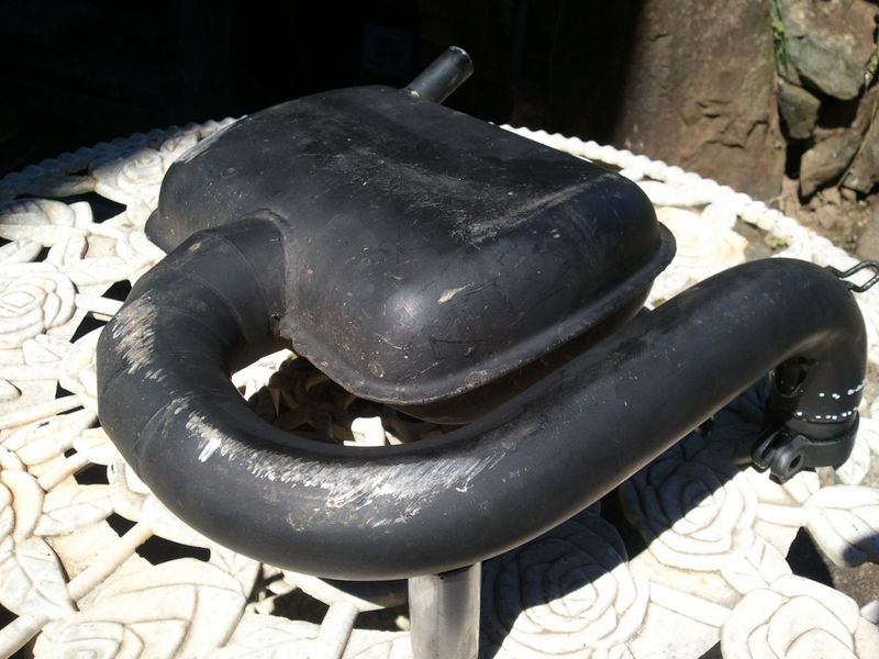

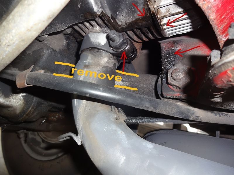

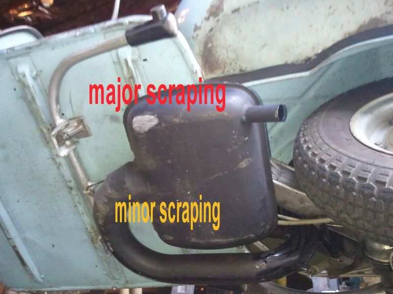

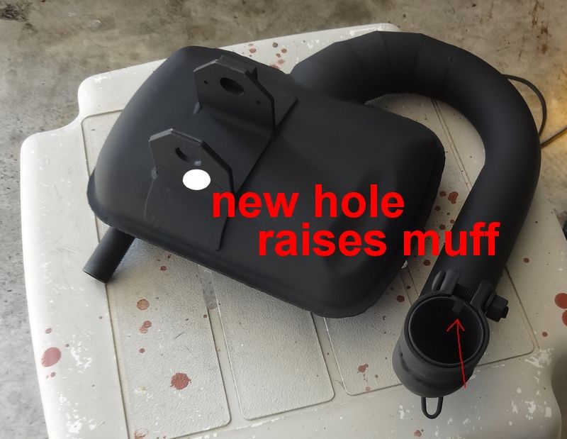

SIP Road mods to avoid scraping on 8's
You may also need to relocate your centerstand spring.
Borrowed pics, identical muffler:
do this first, might be enough
have a good round rat tail file handy,
you will likely guess the sideways location a bit off
do this first, might be enough have a good round rat tail file handy, you will likely guess the sideways location a bit off
tack weld in place if possible
take it to a one man muffler shop if you can't weld it yourself
you can see big gap to swingarm on other side
tack weld in place if possible take it to a one man muffler shop if you can't weld it yourself you can see big gap to swingarm on other side

I was asked about raising the muffler. It was easy to do and hasn't kissed pavement since. I did not need to do anything on the other side as mine had enough slop at the cylinder connection and with pressure from a quart paint can underneath forcing it up while mounting, it flexed up the last 1/16" to get the bolt in w/ muff a quarter inch from the pivot arm.
won't have to change anything else here so that's good
but it could go up a fair amount if it had to
it was falling off before I added the spring

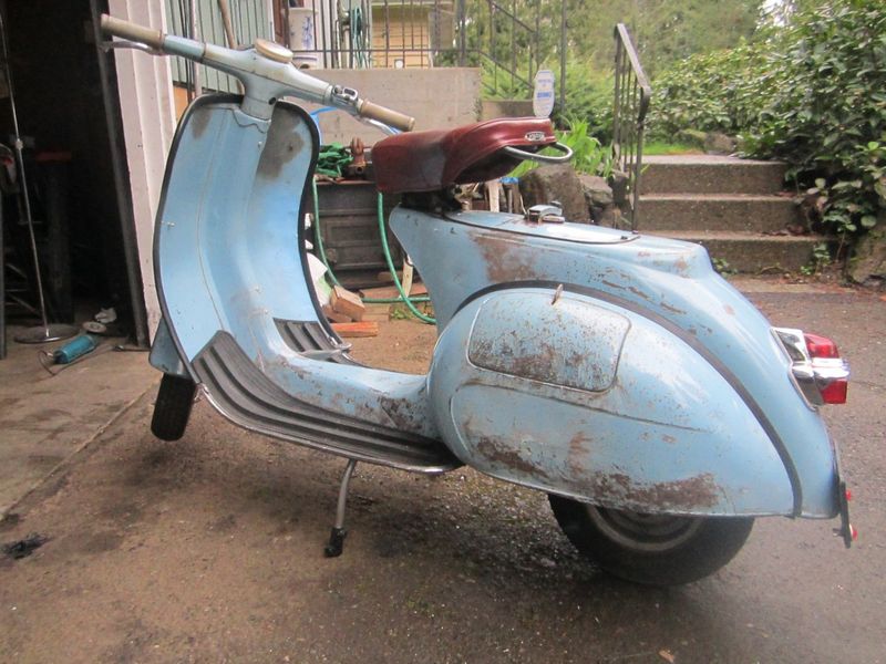

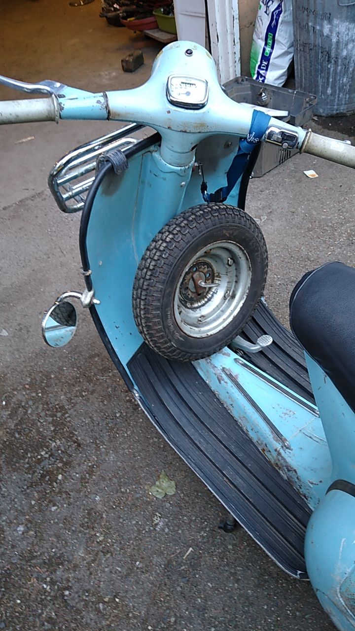

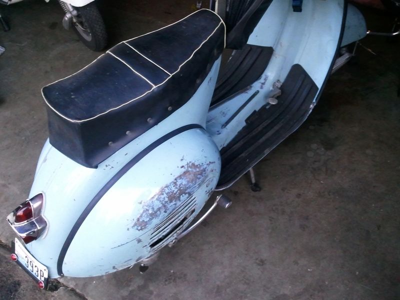

Got the speedo working reliably, if not likely accurately today. Now just minor paint touch up & more buffing until I find that elusive headlite rim.
pretty much done
Rejna bench seat w/ wifey modified Rally cover came out OK for now
pretty much done Rejna bench seat w/ wifey modified Rally cover came out OK for now
I want to use the Denfeld knockoff when it's fixed
love how how it drops in back & covers the hump & gap
I want to use the Denfeld knockoff when it's fixed love how how it drops in back & covers the hump & gap
floor rails, column lock & speedometer all done
even a mirror so I'm legit
floor rails, column lock & speedometer all done even a mirror so I'm legit

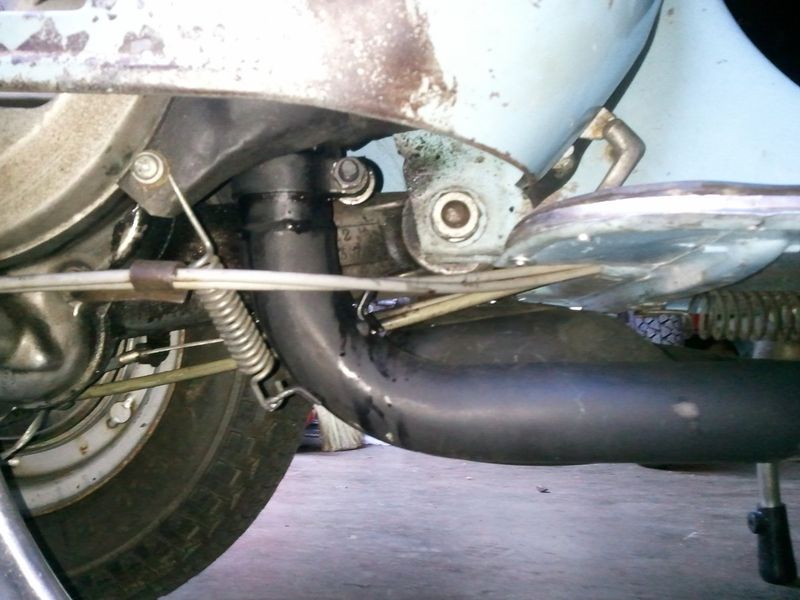

Haven't done it yet, but I'm gonna have to do it. I did have to force it up a bit w/ just the new hole. I was out riding today and the more I get used to the bike, the harder I take the corners & it is hitting on the right turns sometimes
damn 8" tires
First remove muff, cut a piece out & trim the new joint, then assemble to the bike bolting to the swing arm, adjust the joint gap as needed and tack weld it in place before removing to weld closing up the joint. It's close enough to the inlet that I can weld inside too if I have to.
it's still like this as recieved from SIP, but the other side is high enough now
I will shorten this side where marked, seems there will still be lots of clearance
it's still like this as recieved from SIP, but the other side is high enough now I will shorten this side where marked, seems there will still be lots of clearance
Posts: 10121
Posts: 10121
Done it. Compare, no more muff drag.

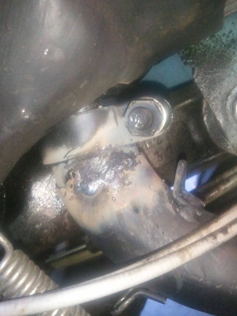

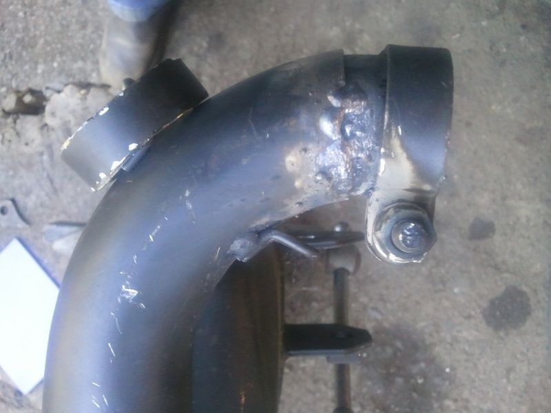

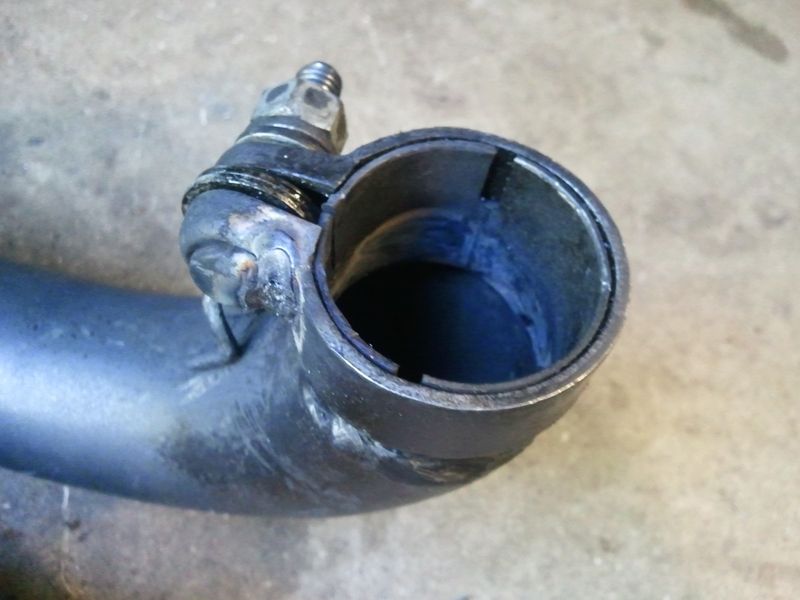

Good point Mike and I just went out for a little functional test run. No matter how hard I tried, I could NOT get muff to touch pavement. Here's what I did to raise it up:
Scraping along the front of the header pipe mostly. Marked for cutting.
Cut at the weld so after deburring I can put the smaller stub back inside the cut off header pipe like it was before.
bolted into the bike and tack welded in place w/ about a quarter inch lap inside
you can see the slight angle from tipping the front of the header up almost tight to the spring
the piece I cut out is hanging on the spring loop
you can see the slight angle from tipping the front of the header up almost tight to the spring the piece I cut out is hanging on the spring loop
continuous weld all around, but a little at a time so I wouldn't blow thru
ground smooth, all painted and looks good inside - job done
the washers in the clamp gap prevent the tip collapsing & force it to clamp tight
ground smooth, all painted and looks good inside - job done the washers in the clamp gap prevent the tip collapsing & force it to clamp tight

Thanks, guys. And high praise coming from you Ebeth! I was gonna go out today and really thrash it some on a nice long and bendy uphill road, but it's wet & a little cold out . Maybe I REALLY need to clean up the shop anyway- sort tools, throw out some junk and put the rest away neatly.
It's pretty bad down there now... Did a motor swap w/ a friend and then this muff - 2 late evening finishes and nothing really cleaned up/put away. Muffler job reminded me how much I hate doing a project when I can't find half my tools or parts
I do like to weld. If you local ppl need something welded, I can probably help as long as it's steel. I bet Ebeth welds up all kinds of shit for his neighbors Razz emoticon

FOUR years later, and my patience has finally paid off! An original Siem chrome rim and very minty reflector showed up and guess where? A block up the street from an old friend who busted the lens forty years ago, so just bought a stock Siem replacement for his old scoot. I was fixing his speedo cable for him and it just showed up in his small box of old parts. Wha? emoticon
My lucky day!

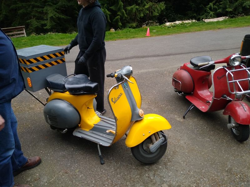

yellow & gray donor bike he's had since college and now getting it back on the road
notice that there's no choke knob because it's piston ported
yellow & gray donor bike he's had since college and now getting it back on the road notice that there's no choke knob because it's piston ported
Siem, both pieces
Siem, both pieces
nice metal reflector and lightly dinged and weathered correct rim w/ halogen bulb to be installed in Siem bulb holder
but my perfect fit lens is by Sagitta and extends a half inch
anybody know who/where they are?
but my perfect fit lens is by Sagitta and extends a half inch anybody know who/where they are?
and a pretty tight beam! YAY!!!!
Notice the modern halo effect from the Sagitta lens 1/2" extension
and a pretty tight beam! YAY!!!! Notice the modern halo effect from the Sagitta lens 1/2" extension

Also a spare tire mount...
And now two tires that hold air, I'd forgotten how much fun this little bomber is to ride!!!
Also a spare tire mount... And now two tires that hold air, I'd forgotten how much fun this little bomber is to ride!!!

Glad you posted this. We have VERY similar bikes.
Going through what you went through with your exhaust. New Pollini box hitting pavement like crazy (with wife in back only, so far )
I see some room to raise it, maybe move the center stand spring to avoid the pirate ship sound while parking, while I'm at it.
Did you modify your underseat choke?
