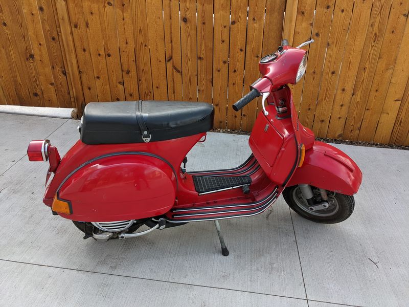

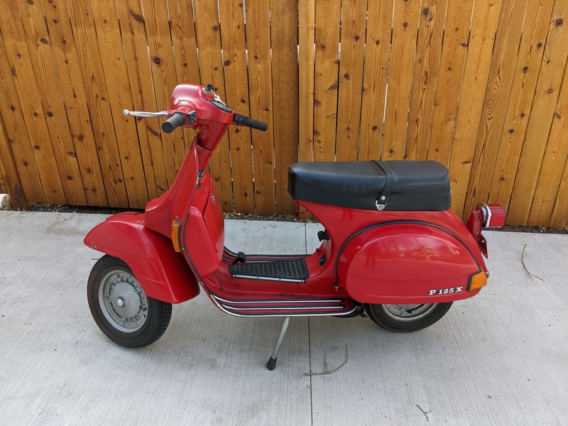

I just finished this P125x and have a question on plug color and autolube. When I first put the motor back in, I was premixing. The autolube had been disconnected when I bought it, so I wanted to get things running before connecting and checking the autolube. It's now hooked up and autolube is working. I had about 1/2 tank of premix left in the tank, which I topped off with gas. It's clearly running rich, as it smokes a little. My plug looks lean - does this sound right? Should I worry about it? Or just run it and check the plug on the next tank?

Hello, out of interest, which colour code is that? Is it a Piaggio colour? I just had my PX200E painted in PIA 2/5 (original colour) and it looks identical. Yours looks great.
Couldn't tell you. That's the way I got it. Original color was silver. The red does look good. How about a picture of your PX200?

Cheers Langolson. That is a nice red. Whoever painted it liked it so much they sprayed the trim piece on the mudguard.
Yep. The legshield trim, the speedo trim and a few other things, too. The good/bad is that they used a quality paint - it doesn't come off with acetone or other solvents...

It looks great. Any reason the it has that style of rear light on a stem? I've seen this type of stem on the us rally. What year was this px made.?
.lovely scooter , congrats

Could be some warped eclectic individual like myself who likes the tractor and tuna fish can lights. Thinking about putting one of them on Stella, if I can figure out how to cover up the extra holes.
I think this tail light was on all of the US P series Vespas. At least the ones I've seen.
It's a 1980.
