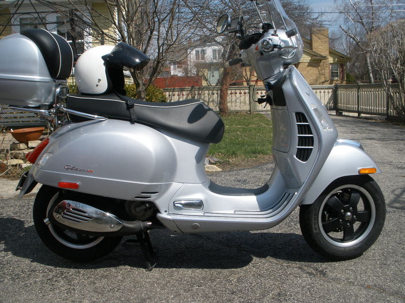

could any one of yous youts post a pic with the 130 mounted on your front, please?? from front and sides, please

For similar reasons I put a 110/90-12 on the front. Definately looks more substantial. Confirm it gives 'slightly' heavier steering, but more stable at speed. If you need that its great. If not, and you do mostly city to country road riding its not much of an improvement. Mostly I think it looks better. I was concerned a 130 up front would be too heavy feeling, so went with this.
oh cool, didn't even realize they have a higher aspect ratio thinner tire... Cool option!
