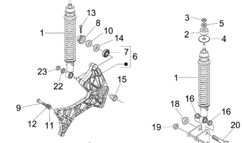

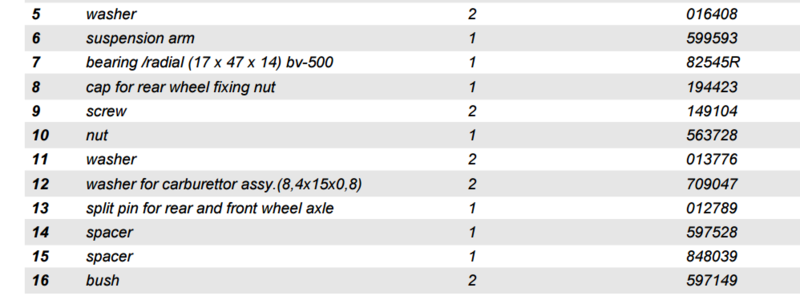

I wanted to get some guidance on replacing 14 and 7 in the diagram for 2005 GT200. It's currently making noise, I believe I didn't tighten up enough when I worked in that area, and now the nut (10) is showing wear from moving back and forth and the spacer (14) looks damaged. I thought while there, I would also replace the bearing (7).
Is this repair fairly simple? is the spacer and bearing pressed in? Also in the diagram, a little confused if the shock has to be moved out of the way?
please let me know if you need more information. I used a torque wrench last time on the nut (10) to 88ft/lb as spec. The guy at the shop say that nut has to be replace everytime if it's been removed, is this true? TIA.

Hardest part will be removing the rear wheel and exhaust. Once the swingarm is off, it's pretty easy to replace the bearing. Search the forum on this. I use a long bolt mounted perpendicular to a bench vise as a home made bearing press to install the new bearing. Set the bearing in the freezer for a couple of hours and the swingarm in the hot sun. Use another bearing and a fender washer, or a socket and a fender waher (that is larger than the bearing diameter) and tighten a nut down on the bolt to get your bearing to press in.
You have a cotter pin running through the axle and nut. I've never replaced the nut when I change a rear tire.

the wheel and exhaust is easy for me, but I have never removed the swing arm before. I do have pin in the cap but there's a little wiggle in it, I bought new cap, nut and pin, spacer, bearing, so i hope to get it all fixed.
thanks for the suggesting.

The castellated rear axle nut gets re-used for the life of the bike. Your mechanic friend is full of BS - unless he thought you were talking about the variator nut. *That* should be replaced every time according to the manual with its integral belleville washer.

I have to do them every so often when they get so rusted on that yanking them off damages the bearing.
Get a big ole hammer and wack the old bearing out with something then find a socket just slightly smaller than the new bearing and wack it back into place. Remember to only hammer on the outside edge of the new bearing.
