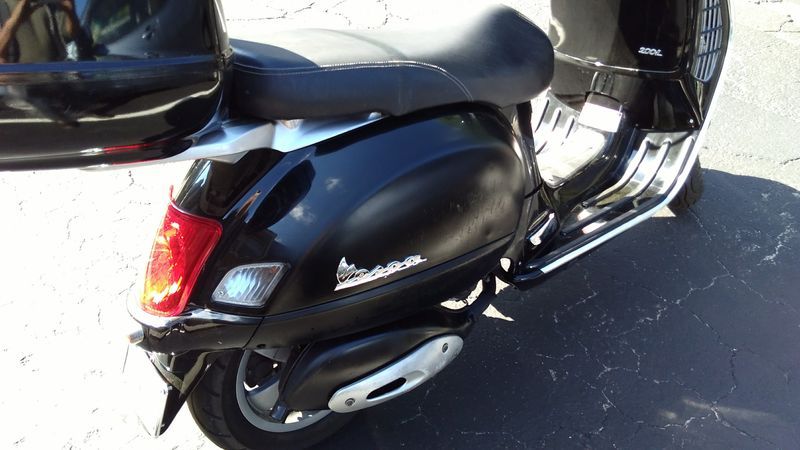

I am thinking about installing a reasonably-priced aftermarket exhaust on my 2010 GTS300.
Rather than succumbing to the best advertising, I am wondering if the 'wisdom of the list' has a consensus suggestion?
I am assuming an aftermarket system will provide some improvement in performance and maybe even mpg.

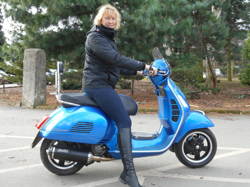

My preference would be an Akrapovic. They look well made.I am biased towards it though. If my original ever rots out, that is what I will get. Don't expect much in performance gain without other work. So I heard.

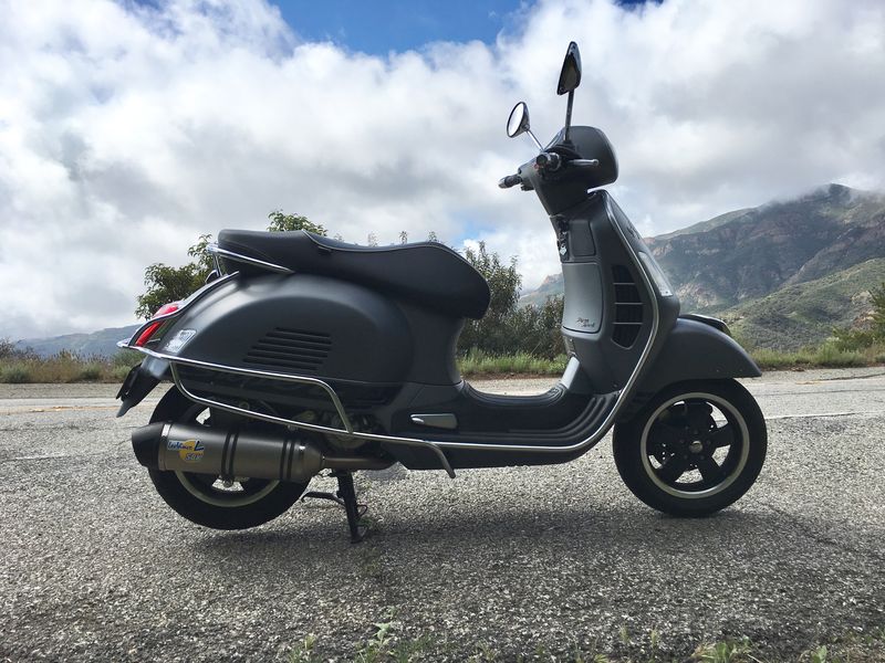

If you want sound and style matching Akapovic but about $150 less check the Malossi RX black edition. I've installed both on different GTS's and definitely like the Malossi just as much.

Glad to help! The bars are the OEM Vespa and they do not interfere with the exhaust. The older Vespa bars by Logo Scooter used to hit the tip of most aftermarket exhausts so thats the warning you'll see out there and it is outdated. Scooterpartsco.com has the Malossi for $389 and you can get it within a week. Easy straight forward install.

Slip on, exactly like the Akra. I did the stainless manifold at the same time, nice growl but not obnoxious. Just enough to make it sporty.

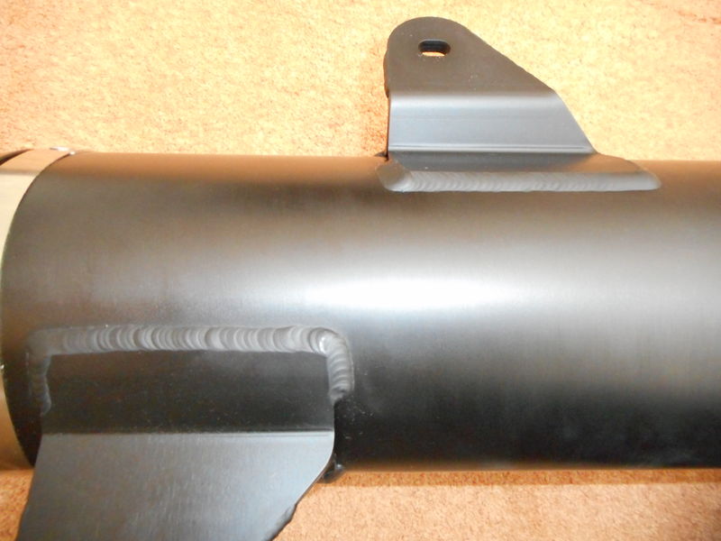

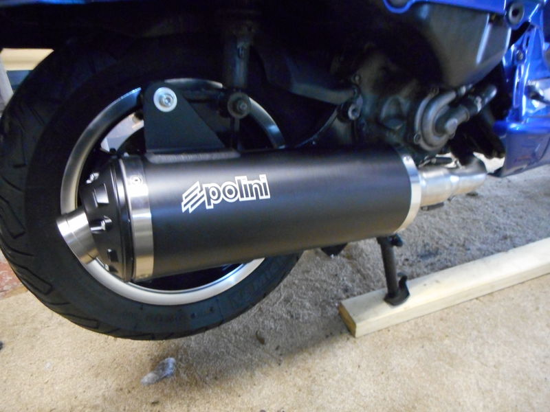

Polini, Not loud, just a deep growl. Its a slip on.
Wow that looks great , where did you get it from?

I like the Akrapovic for the quality, the shape and the upswept angle. It just looks like I me it belongs on the Vespa. No offense, but many of these he others hang low or level with the ground, leaving a big gap between the scooter body and the top of the muffler. Kinda like it "was" added on. Just my opinion.

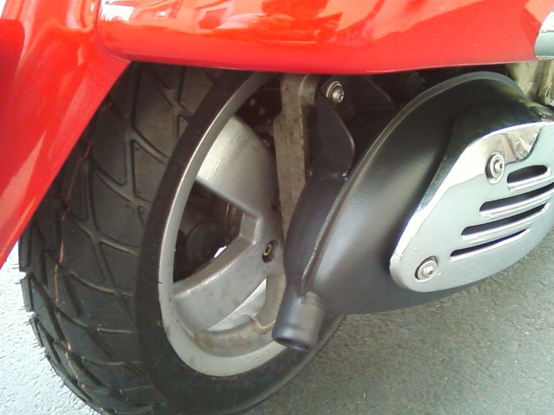

I think the stock exhaust starts to look a bit ratty well before it wears out; Melody's pipe is just starting to have bits of its paint flake off - nothing horrible yet, but I'm betting that in a year's time I'll be looking to have it repainted. I also happen to like the sound of the stock pipe...it has what I'd call a appropriate rumble for this bike, neither wimpy or ridiculously outsized.
Got it of these guys mate, only had it a couple of months, well made though with good welding, its gone up £36 since i bought mine.

You know that look you are describing is because the scoot's pictured are on their center stands and the exhaust is attached to the swing arm creating that effect? Once the bike is on the ground that gap completely disappears and the exhaust flows with the lines.

I have to agree with Mr Happystrada, this sweeps up nicely imho.

The Akapovic looks to be more upswept to me, and flows with the scoot, IMO. Maybe I am wrong. It just looked me like it was made or came on the scoot-rather than added on. All a minor issue. As long as your are happy with yours, that is what counts.

I think rust on the standard one is a relative thing - if you leave it, don't clean the scoot, ride in all UK weathers etc then it'll rust, though other countries with different climates just don't seem to get the rust issues we get in the UK. My original exhaust on my 2009 did rust quite badly, but I bought a second hand replacement that was pretty much new, stripped all the old paint completely off, replaced with a good paint (Thermacure) and it's been fine for a few years now, with the odd check and paint top up. I don't do massive miles (day trips then long euro tours) and I've just got used to caring for the exhaust like I would any other part of the GTS....

When I bought my GTS brand new the exhaust paint peeled off at an alarming rate within 7-8 months, I wire brushed it off and sprayed it with a heat resistant paint. A few days later some sod knocked it over and damaged the paint and other bits and bobs including the exhaust. It was replaced by the insurer and, 18 months on, the new one is fine. I suppose that's Vespa's for you.
