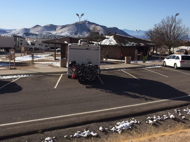

Our RV Setup
We have a twenty one year old Class C Motorhome. We have been across country several times with a double Versahaul for the GTS and the Fly 150. It is not too much weight when attached to the 1 ton chassis, but I would have to think that attached to a travel trailer, it might wag things. The most recent trip, we took just the GTS and rode two up all the time, and put bicycles in the other tray.
