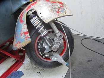

What did you do for upgraded brakes on your GT? Disk brake?

SIP PK fork, Grimeca fully hydraulic front disc, upgraded caliper, front and rear Malossi RS24 shocks, and F.A Italia tubeless split rims

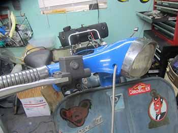

Another look and a look at the headset with plate for master cylinder.
