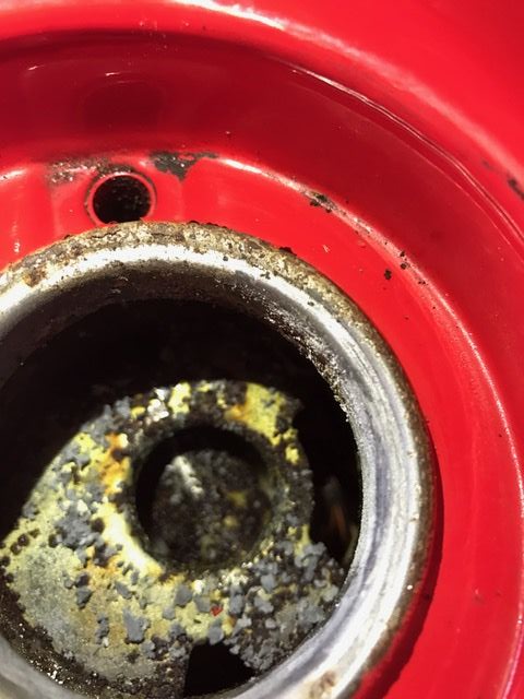

My friend just got a FREE MC that had been sitting with gas in it (ethanol gas and no seafoam) for 3yrs. Here's what his gas tank looked like. Good thing he didn't try to start it. Clumpy stuff used to be gas. Wha? emoticon
@cdwise avatar
GTS 300, Buddy 125
Posts: 8902
Location: Knoxville, TN
@cdwise avatar
GTS 300, Buddy 125
Posts: 8902
We've been cleaning the rust out of our gas generator in preparation for hurricane season. Even with Stabil in it the ethanol wept water. Petcock was clogged with it.
