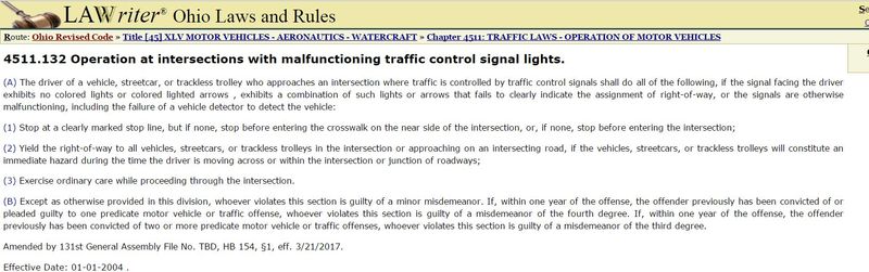

I have had similar issues, but, the only solution I have is, after waiting awhile, and traffic has passed, proceed, accordingly, with caution.
As I live rurally, there are many intersections the constant flow of traffic is one direction (N - S, for example), until a vehicle approaches the intersection (W - E, for example), to actuate the traffic light. I will sit, sit, wait and wait. The sensor has not detected me; even, if I stand, walk and roll Scoot back and forth to try to get the sensor to detect me and Scoot. Hence, I proceed, accordingly, with caution.
Though, on March 21, 2017 (this past Tuesday) Ohio law now allows drivers to pass through red lights if they believe the intersection has a malfunctioning traffic signal; including, if the sensors have failed to detect the vehicle. Though, the law does not specify how long a driver must wait before determining that the signal is broken. So what is reasonable to me, "exercise ordinary care while proceeding through the intersection," may not be reasonable to another.
If the law is read verbatim, the law only addresses the driver of a vehicle, streetcar or trackless trolley. Hence, I will take the "driver of a vehicle" to be any thing other than a streetcar and trackless trolley.
Hence, this is causing concern for many people; aside of law enforcement and insurance companies, but, the lawmakers who passed the law. Wha? emoticon
The Wild West has now started in Ohio. Let the red light runners be at the front of the intersection. Headache emoticon
