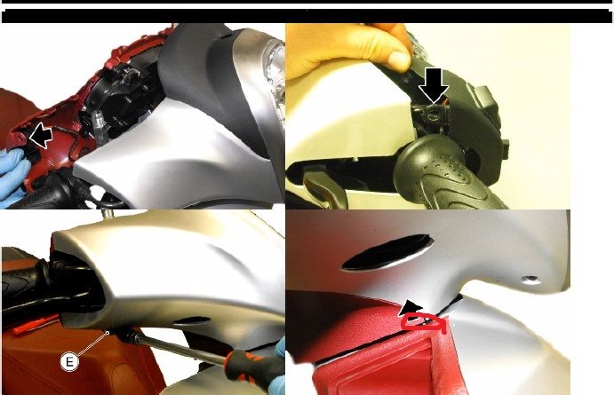

Separating the two plastic pieces is for me, the biggest PITA on the bike. The manual gives a half-assed description of how to do it. Their picture points to the wrong area. I ground an allen wrench flat like a screwdriver and pulled the plastic catch out from the inside to release them. When I push a small screwdriver in the slot, it won't release for me.
The slot is under the arrow in the picture, I circled it.
Thanks ... i may try to play with it but will prob give it to the dealer to swap out the brake lever. Thanks for the pic , H.
