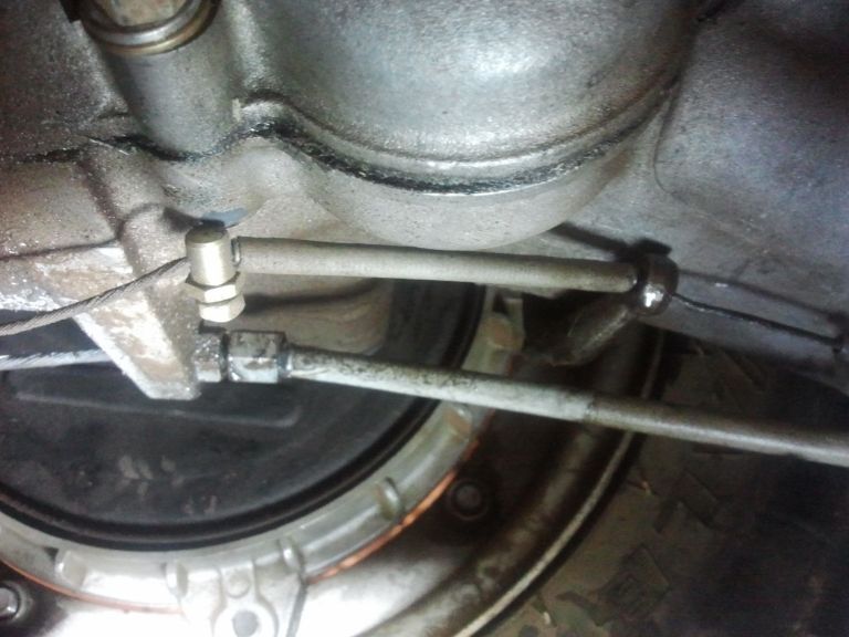

Been trying to track down the cause of an intermittent throttle sticking at wide open. had replaced the cable, housing, and carb so last place it could be was the oil pump.
There was nothing obviously wrong with the internals of the oil pump but there is this small mark where the lever hits the case at WOT. Gave the lever a small tweak with some pliers so it's now parallel to casting and it does not rub there any more.
Fingers crossed that was the cause.

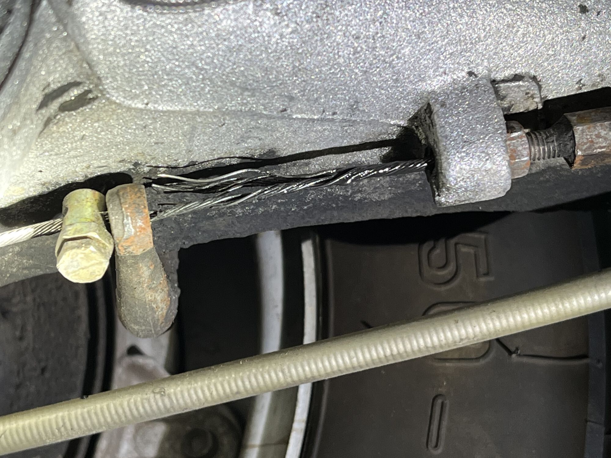

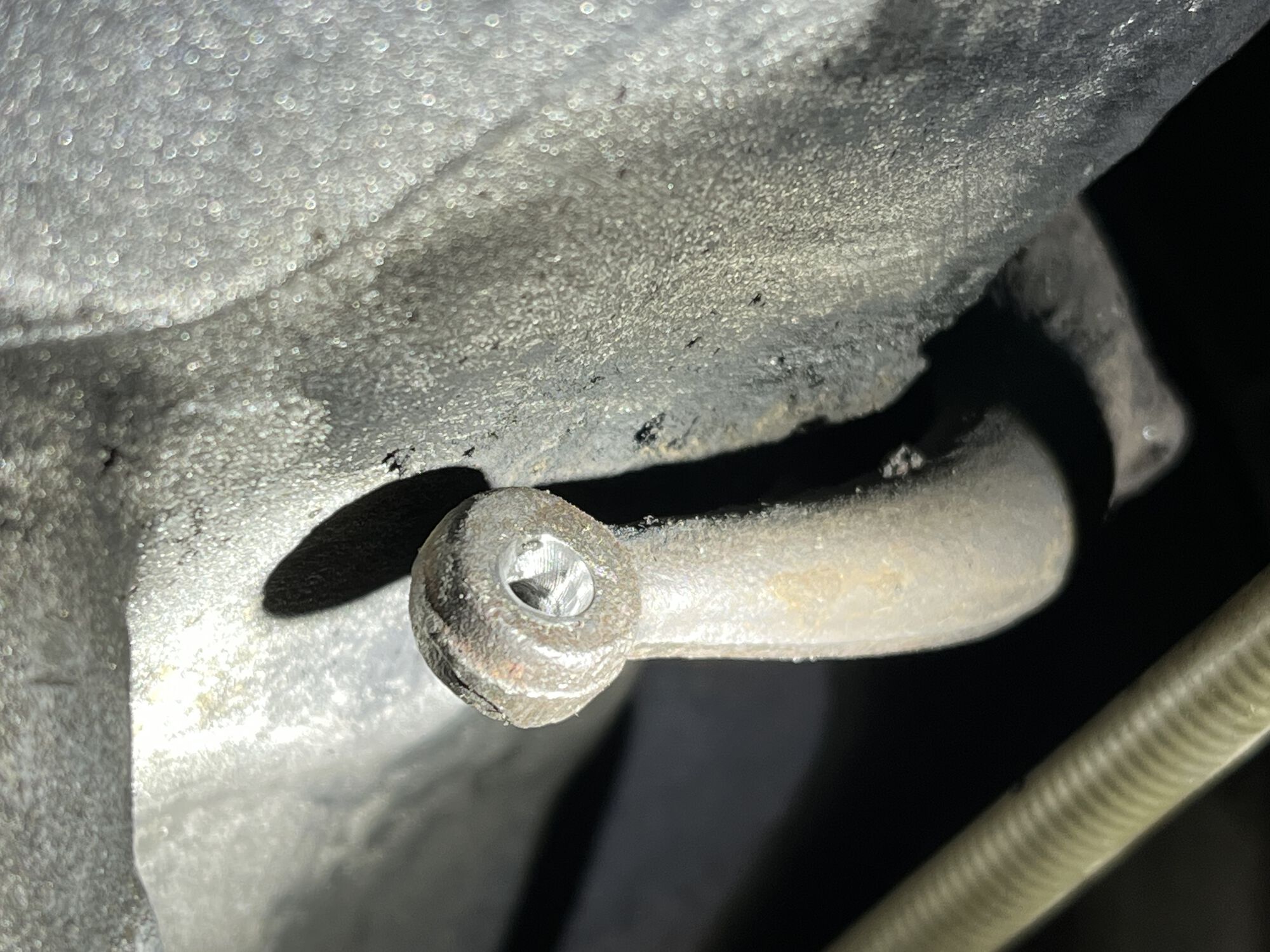

Prepping for the Melee, clutch lever had developed some slack, typically means the cable is about to snap, I should look at that
@ginch avatar
Posts: 10013
@ginch avatar
Posts: 10013
At least 8 wires in that cable are good for another 1000 miles.
Facepalm emoticon

Yup, but easier to change it at home
Beveled the exit to give the cable a fighting chance
@ginch avatar
Posts: 10013
@ginch avatar
Posts: 10013
Of course. I forgot the "lol".
You've seen this before, it avoids any bend at the lever.
