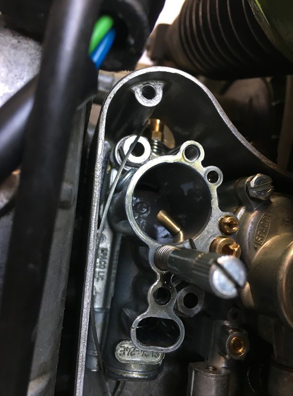

I did controlled the exhaust. Not clogged. Carburettor is wet, see the picture below.

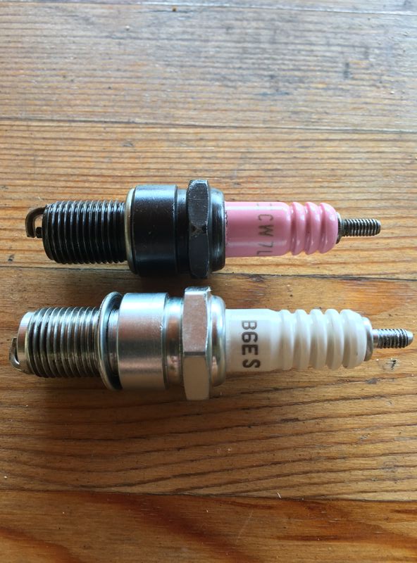

8) changed the sparkplug with NGK b6es, saw sparks outside, plugged in, kickstart, nothing, even no cough.

Carburettor as soon as filter removed
Magneti marelli plug cw7lp
Both plugs
Both plugs

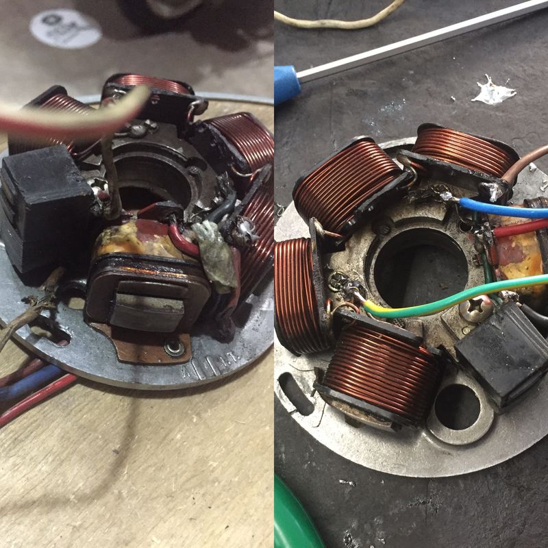

Back to work. I had replaced magneto plate cables since I noticed that there were burned cables and improperly connected cables.
Now I had assembled everything this evening. Placed the plate exactly at the same position. Kickstarted, no sound of ignition. Sprayed a starter fluid, it is perfectly running, smoother running noise compared to previous run. Choke closed or open does not change the start.

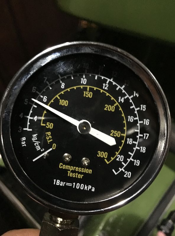

Then I had measured compression, see below. I do not know the ideal value. Gasoline is new.
Is it time to adjust timing ? Or I should do smt else ? [/img]

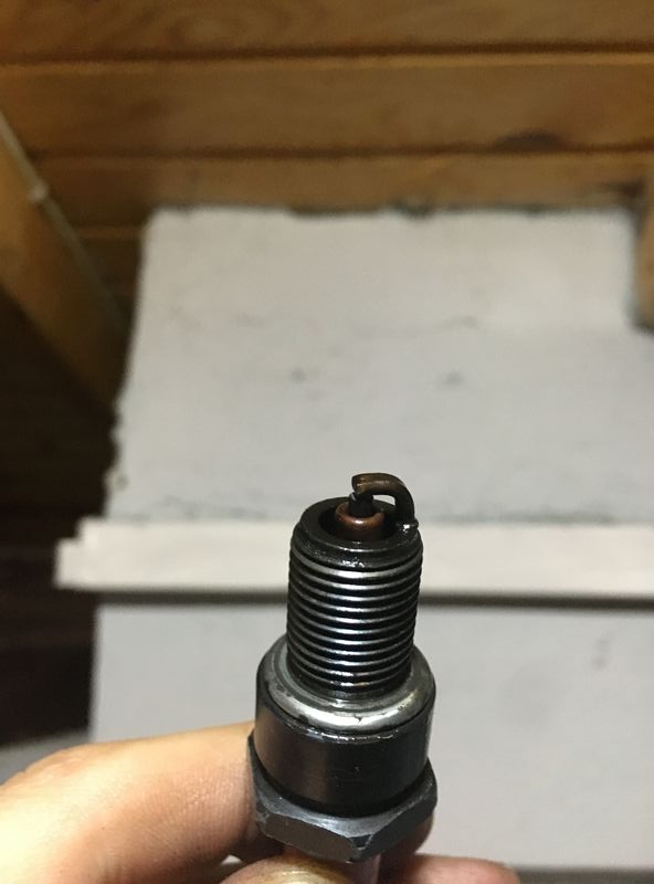

By the way after I shut the engine off. Status of the spark plug is attached

4) that compression read is WAY off - either it is wrong, or you have very very poor compression. 70PSI isn't workable. I suspect the reading is just wrong. Can you tell us exactly what you did you get that reading? Did you kick more than once? Did you hold the throttle open? Is this a read with a warm or a cold engine?

Low compression, wrong spark plug and very wet. I would start from the cylinder / piston and move to carb / fuel delivery...

That compression reading could easily be not correct. A B6ES is fine and is not causing their scooter to have trouble cold-starting. Seriously, we need to know more about their testing methods and the situation before stators get rewired and cylinders get pulled for rehoning and rings.

The spark plug pictured last is definitely not a B6ES. It has a protruding electrode so it's not the correct one. About the compression, I would agree with SoCalGuy. Stator wise, from the pictures he posted, I see a rotten wire on the left picture, so a rewire wasn't a bad idea...
You're right, the electrode is protruding far and it's got the black metal. The OP said they switched over to a B6ES above - I guess they switched back.

The windings were fine, cables had to be replaced as far as our electrician has already stated. After all the work, we see that the sparks are healthy and brighter.

I am with SaFis. That compression is way too low if that is the max you can get. You should be seeing something in the range of 110-130 on that scooter with a decent condition top end.
You should use the correct NGK spark plug, and your scooter definitely should not be backfiring. Can you snap a picture of your stator plate's position on the scooter?

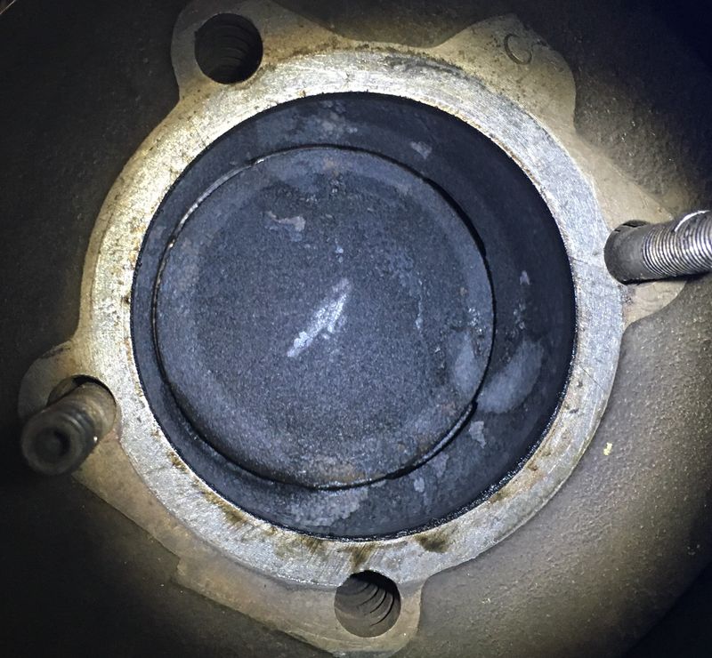

Following up the lead for the compression value, I had removed the cylinder head to ser inside. Strangely, I had observed that cylinder head gasket is missing. This has an effect ?
Cylinder bore is clean, without scratches, piston looks fine.
It resulted to me the cylinder diameter is 68.5 is this a correct reading ?
See the pictures...

There is no head gasket, only a base gasket between the cylinder and case.

Dear Vespisti,
Further notice,
I did removed cylinder, piston etc and realised that piston rings are worn out, cylinder is rectified to the last end scratches in lower portion (69 mm !).
So, I had started to rectify everything (even gaskets bearings everything on the engine).
Today parts have been delivered, most probably I will be posting some nice photos within next week.
Thank you to all.

Maybe it's my eyesight or the photo, but the brass nozzle into the venturi looks bent in your shot of the carb with filter removed.

Too many issues here...try another stator,new or remade and see results.THERE IS NO GUSKET BETWEEN HEAD AND CYLINDER ON vespa PX.

If there's one thing on my '79 P200E that's finicky, it's the carb. Yours sounds like it's doing what mine does.
Most of the time she's a second kicker, but every once in a while I'll try starting her and 30 kicks later nothing. The carb rebuild helped tremendously. I'ts like $20 and an hour's work.
Mine floods easily. Once I get it started it runs like a champ and after it's warm it restarts without an issue.
My process for starting it when this happens is just to push the choke all the way in, grab the throttle and open it all the way up and kick until it fires. That opens the slide all the way up and sucks in as much air as possible. Usually after about 10 kicks she'll catch and smoke like crazy until the excess fuel is burned off, but normally I'm good the rest of the day.
it certainly sounds like you have a fuel problem. Try shutting off your fuel tap at night, too. If it's leaky this will keep excess fuel from bleeding through.

Will you use same piston, hone the cylinder and install new rings
or
new next oversize piston & rings then rebore the cylinder?
Be sure to check cylinder bore for excessive out of round or taper along the bore before you decide to hone only.
Hard to tell here, but bore maybe looks to be getting big for that piston.
Look again & think reflection.
