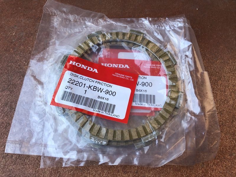

Jumping on the CR80 clutch plate bandwagon for the P222. Currently the P222 has a banded 7 spring with Pinasco springs it works OK.
After installing a BGM Superstrong with CR plates in the Bajaj CR plates seem better.
Going to use a Onkle Mike clutch spider https://www.scooter-center.com/en/clutch-spider-onkel-mike-ddog-cnc-type-7-springs-friction-plate-type-honda-cr80-oeouter-115mm-oeinner-108-vespa-rally-180-vsd1t0014741-rally-200-vse1t-px-200-vsx1t-t5-125cc-vnx5t-cosa1-125-vnr1t-cosa1-150-vlr1t-cosa1-200-vsr-3333569
Will use my straight cut 24T gear and Pinasco spring cups with the hole that have been removed from the Bajaj.
Question about the number plates. Notice on the SIP equivalent basket describes as potentially having extra space for 3 or 4 plate set ups. Wonder if Onkle Mike's has the same? I see Ginch built his 7 spring TENINCH with 3 cork plates.
Which leads to the next questions what thickness plain steel plates? Seems there are 1.1, 1.5 and 2mm available. Is thicker better provided there is space for it? Perhaps number of cork may dictate plain steel selection? Notice the spacer Demetrios linked removes unwanted space and moves basket inward if I am interpreting that correctly same as thicker plain steel?
I think 3 is the maximum you can fit into a 7 spring, and 4 in the Cosa - due to the more compact spring design no doubt.

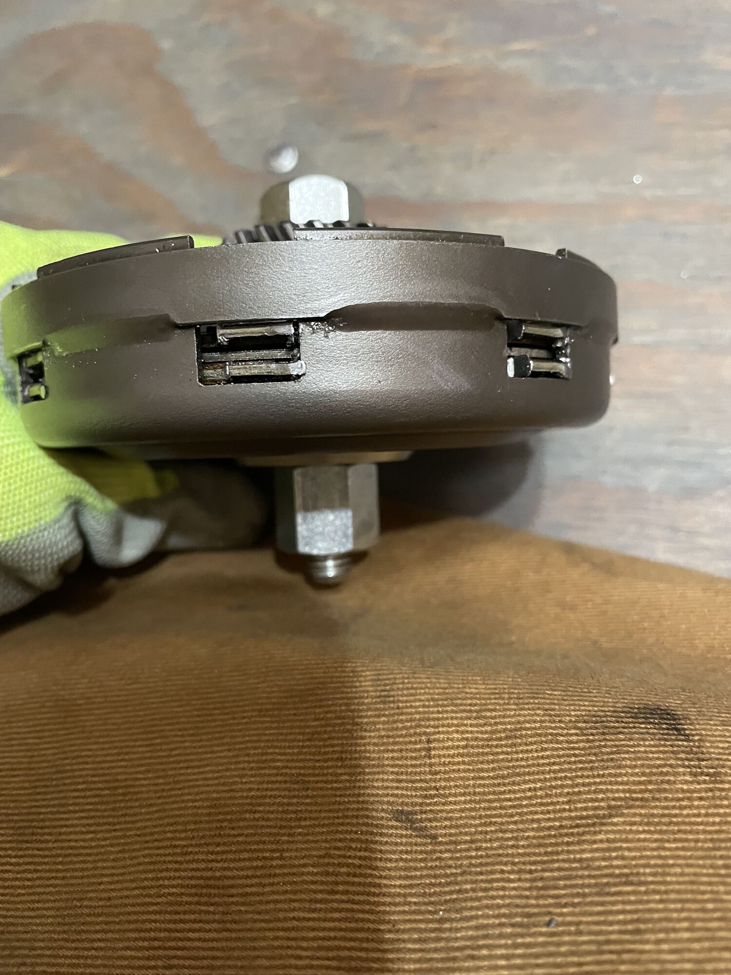

SaFiS wrote:
Did a Cosa clutch today for a Malossi build for my cousin. Outer ring, CR plates, SIP reinforced bushing and BGM circlip...
Just wondering if you needed to grind the tabs on the banded clutch basket?
I have a standard cosa clutch basket with a SIP strengthening ring welded on but the CR80 tabs touch the ring.
Im a bit worried that I grind too much of the tabs to make them fit…,

roland87 wrote:
For CR80 plates you need 10W40 JASO MA2. Elf, for example. Or Motul Trans Oil 10W40
Exactly where my line of reasoning was headed.

I had to grind the tabs too on my SIP banded COSA2. Opening it up today so I'll have a look at wear marks if any. I also have a big clunk when shifting from N to 1st gear sat at lights. It's as if the clutch isn't separating fully but it shifts pretty good when riding. How would i increase the plate separation? Picture is the original COSA plates supplied with the clutch. Changed em out for CR80's.Thanks

If the clutch is just dragging a little, you probably just need to back out the clutch fine adjuster a turn or two.

Thanks Chandlerman just opened it up and everything looks good. Moving from 22 to 23 teeth to give me a little more top end too
